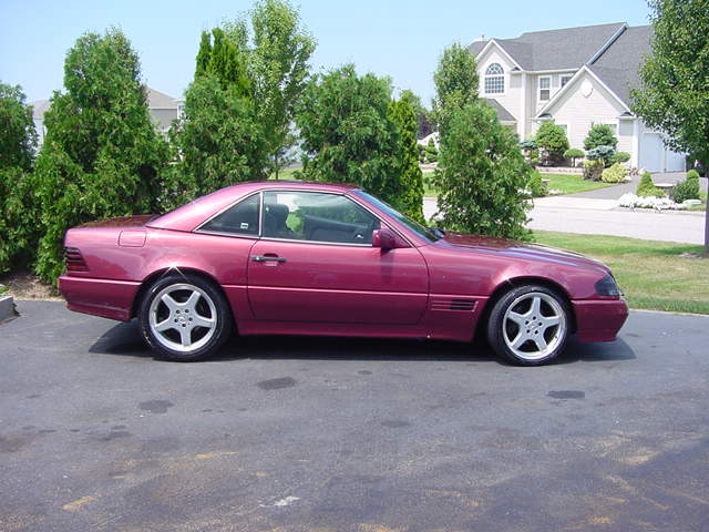

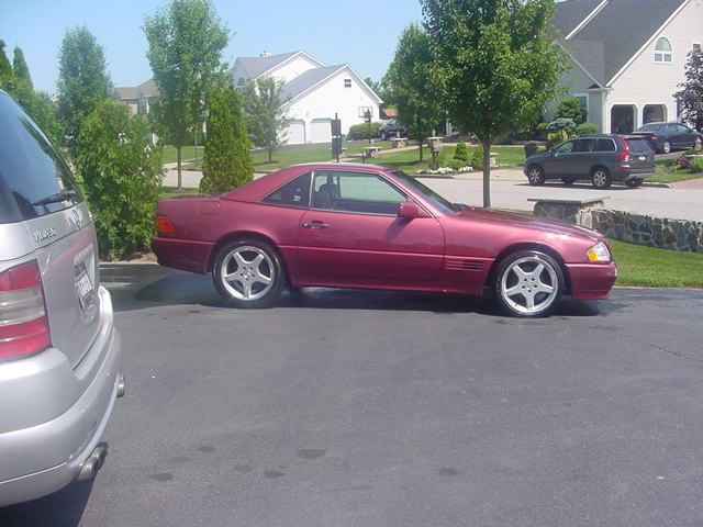

heres what i did with harbor freight speed buffer and regular cheap products
wet sand 1200/1500/2000 depending on paint condition
i like to work in sections (MEANING WET SAND/CLEAN THE SECTION THEN COMPOUND)
turtle wax compound green bottle with yellow foam pad
turtle wax green bottle with black foam pad
nu finish with white pad
good affordable buffer/polisher?-tnylaob.jpg
Attached Thumbnails good affordable buffer/polisher?-001.jpg   good affordable buffer/polisher?-008.jpg
