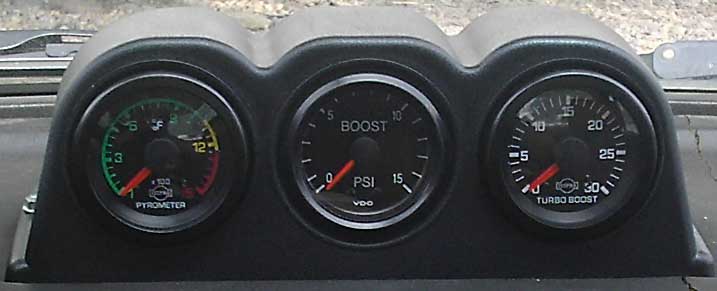

I just finished installing my ISSPRO pyrometer and a few test runs. As you can see from the video, I was surprised to see it get that hot. The video cuts off a little short, but it got to 1400*f by 4500rpm. It seems the water injection does NOTHING to lower EGT's. There was no difference between runs with/without it.Sitll, it does give the engine a little more "kick".
Next mod in line for installation, air-water intercooler.
The boost gauge on the right is for exhaust manifold pressure. There must be a leak near the gauge because it pulses/vibrates while under load.
