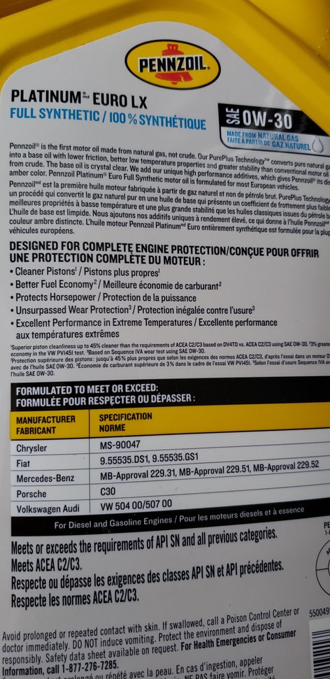

I don't use a Mercedes spec oil in my Mercedes diesel , although some oils may also have it as an additional manufacturer spec .
What I use .

Old Aug 6, 2021 | 11:11 PM
  #638
Gazwould's Avatar
Joined: Sep 2018
Posts: 882
Likes: 159
S204 C250 CDI Sport
Best of both worlds , the protection with the fuel economy .

The biggest concern with the OM642 is OIL DILUTION due to high biodiesel content at the pumps (that ends up in the sump in short order, especially during during DPF regen cycles). If you have no more than 5% biodiesel content (B5) and no DPF, my first choice would be a good HDEO oil like a Shell Rotella T6. Excellent protection and cheap to boot.
Naaa , it was tested by a mechanical engineer for high temperature film strength and came 218th out of 248 oils tested .

Basically all modern motor oils do have good film strength.
What makes win or loose on SCR equipped vehicles is the chemical balance they can keep.
Even the best film strength will not help when oil turns into pudding.
