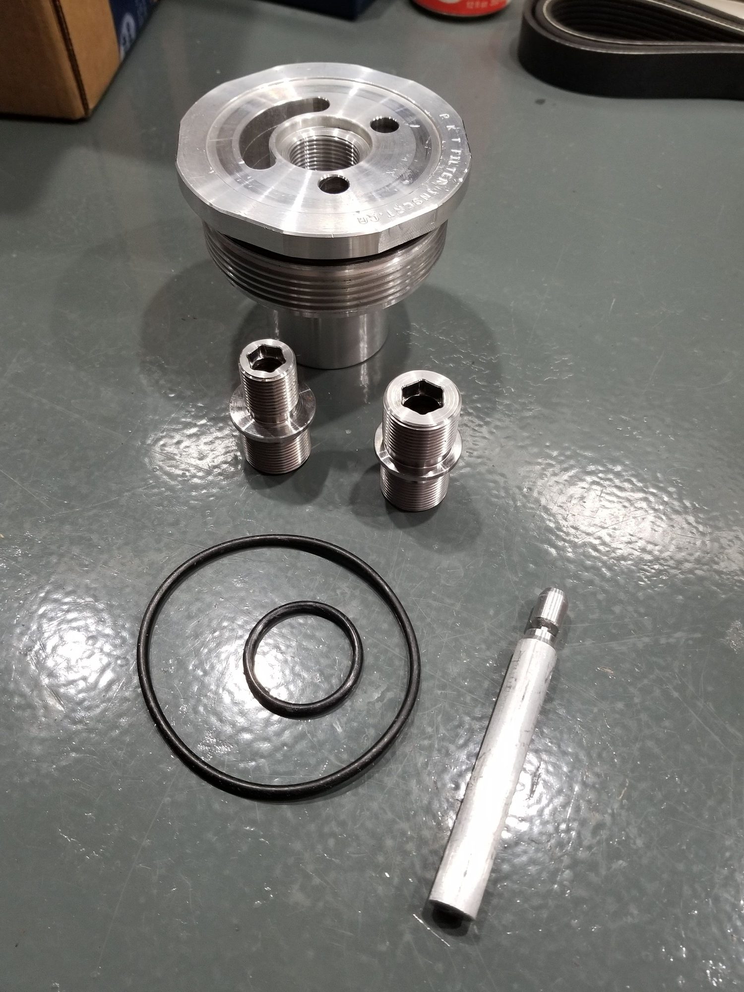

Well, I just purchased a filter adapter for the truck. Just my luck, it's from out west in Canada so no duty fees etc...
Converts the OEM set-up to a spin-on type filter with much greater capacity. If I remember correctly, the recommended filter is a short or long version designed for Caterpillar engines. After that's installed, I imagine it'll be easier to convert to a single or double remote filter set-up. That's if I even have room for either.
I'll probably be fine with just the spin-on.

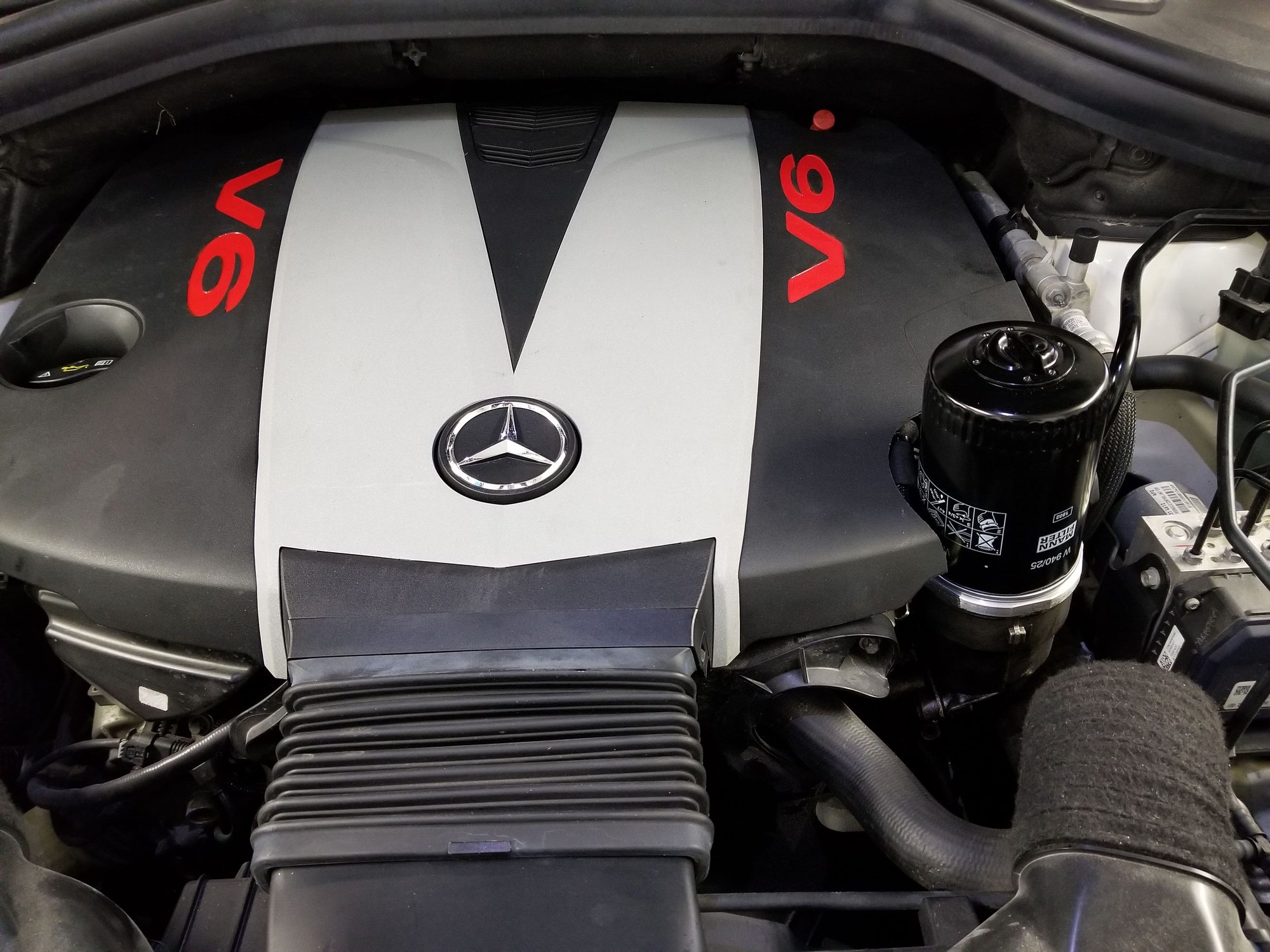

Got it back in September, will be installing it tomorrow. You can run a small(er) or larg(er) oil filter with this set-up, which looks to be rather well-made.
The instructions state: "Small filter is a Mann W94025. VW 1.6 diesel. Or, large filter PN5083285AA, filter for Dodge Ram 6.7 Cummins."
I'll be buying both tomorrow and seeing if I can fit the larger filter. Only around 5" clearance between the present oil filter cap and the hood, so...

Did my oil change today. Put engine flush in, ran at idle for 10 minutes. Drained, refilled with cheapo oil and ran for another 10 minutes. Drained, added Amsoil 10W/30 Signature Series synthetic and did the oil filter mod. Even though I only had room for the "smaller" filter, it's still pretty big.
Dropped the ball on two things;
#1 I forgot to pour some of the old oil into the Blackstone container. Dumba$$
#2 I didn't think to check for clearance between the engine cover and the oil filter. I'm used to not seeing the cover in place, as I remove it in the summer. At the next oil change I'll mod the cover

In your estimate, how much more filter surface are you gaining with this filter over dropping in an OEM unit?
Old Oct 28, 2018 | 08:14 AM
  #37
peter2772000's Avatar
Joined: May 2017
Posts: 1,234
Likes: 155
From: Montreal/Cape Coral FL
2012 X6 35i Sport, 2013 ML 350 BT, 2019 4Runner TRD Pro, 2020 CRV-AWD
I want to say double, but what do you think?

I think you are correct considering the overall inside construction of the fram filter. It would be nice to take apart used MB filter and measure the overall filtering surface and then do that with the other option like fram. This ofcouse does not measure down to what size of particles the filter media traps but is a start in overall efficiency comparison.
this option does provide some additional cooling for the oil.
is there any availability of a remote oil filter kit that would allow for a taller filter to be mounted remotely and as such would increase filter capacity not only in amount of filter media but also increased amount of oil for those older om642s and also increase cooling capacity.
I should add that I believe never om642 oil pans have changed and hold few liters of oil more. Are those direct bolt on to the older om642s that have 8.5L capacity?

8.5l of oil for 3l engine is a lot.
In the past I had 5l GM diesel who took 4.5l of oil. Not that it was good engine, but oil capacity worked.
Oil filter will not add cooling capacity you can measure.
642 is first MB diesel I know that has liquid -cooled oil and I don't think cooling is any concern.
That really looks good. When you change the oil, does this filter "drain" back into the engine or do you have a BIG mess with oil going everywhere?

x2. mostly concerned about restricting flow. Would you think it has increased or decreased the flow. It has to be different. Would be nice to be able to measure to be sure.

I don't know if it creates a mess or not, I only just performed this mod. I'll post back in 3k miles when she'll be due for her next oil change.
As far as decreased oil flow, I think it'd be the opposite. More filtration area should increase flow, I'd think.

Take a look into your oil filter housing the next time you replace the filter and compare them to the openings in the adapter. Trust me, the supply/return openings are plenty big.
As well, I just remembered that my FJ Cruiser also has an inverted oil filter and it leaks just a bit when removing it. I'm betting that on the MB, the majority of the oil in the filter will drain back down into the engine when the engine is shut off.

Engine cover trimmed using a 4.5" hole-saw. Black filter definitely looks more at home.
Also cut a 4" x 4" square opening in to the belly pan c/w a triangular section to accommodate the trajectory of the oil when the plug is removed. I HATE removing that belly pan, now I won't have to for the fall/winter/spring months. Sorry, forgot to take a pic.
Looked for damaged filter material etc. Move on folks, nothing to see here....
Got about 2-3 ounces of spillage when I removed the oil filter. The crappy rubber check valve they use is probably to blame. Anxious to see how the Mann filter is built, and whether it'll leak as well.
Sorry to bump an old thread, but where did you get that filter adapter? Would be interested in something similar if the price is right, want to add a bypass oil filter and with this I could just get the dual filter option from Amsoil.
