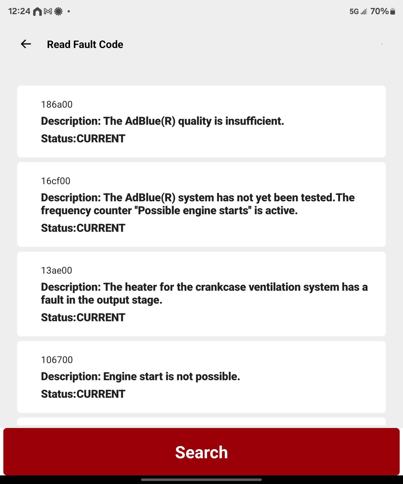

Tried thinkdiag mini. It's pretty good actually. Got to the root of why and what needs to be done. Scr (bluetec) has 0 faults now since repair was done. This one can't do the adblue reset or testing.

I couldn't wait to set up the Xntry and deal with and straighten all the issues out. So I researched deeply into available scanners and found one new gem called TOPDON Artidiag EU. It works with all European cars at a dealer diagnostic and actuation level and supposedly coding too. Ai said it wouldn't work, and was wrong as I suspected.
First I got Ancel Bz700 which is made only for MB and claimed adblue faults resetting, didn't work at all.
Topdon EU for around 180 USD does things I didn't even expect.
Fixing SCR/AdBlue No-Start Issues on Mercedes with Topdon ArtiDiag EU
No-start condition, or countdown for other reasons than adblue tank empty
Procedure Using ArtiDiag EU: (This procedure will obviously work with any scanner of similar or superior capabilities)
1. Go to the ECM (CDI module):
Navigate to Special Functions.
Perform all available resets related to SCR, DPF, AdBlue, NOx, in the listed order. This will clear the no-start lockout. The engine should now start, but warning "check adblue, refer to manual" will be there which means count down will start again in a couple of drives.
2. Clear all DTCs
Return to DTC menu and clear all current and pending codes from CDI and other related modules.
3. Go to the SCR Module:
Though this may show no fault codes, navigate to Special Functions in the SCR module.
Perform the single AdBlue reset available here. Note:there are many adblue resets here but will all refer you back to ecu(CDI) except for one, which was necessary in my case.
Result:
Engine starts
No fault codes remain
“Check AdBlue” message disappears
