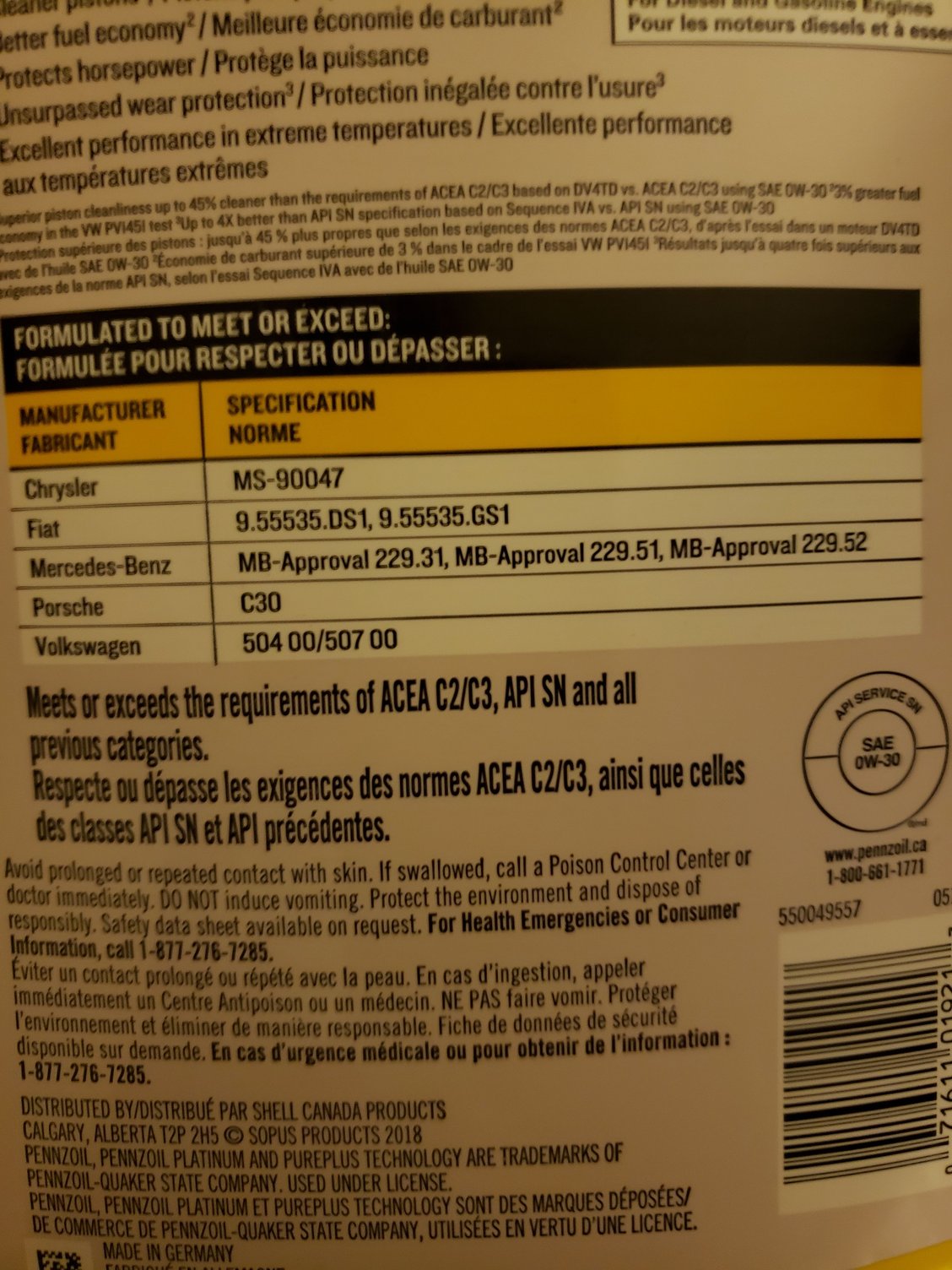

For those who don't already know, 229.52 oil is now widely available in the form of Pennzoil Platinum Euro LX 0W30 at Canadian Tire. It is even on sale now for $30/5L less Pennzoil rebate of $10 per jug. At $20/5L this is one third the cost of equivalent spec oils like Lubri Moly!

Still showing 57$/5L for me on the Canadian Tire website. I get mine from Napa and it's the Mobil 1 0W30 ESP X1 at about 9$/L.

Thanks, I just picked up 4 x 5l jugs for $140 tax included. With the $40 rebate thats $5/l. Great price!
