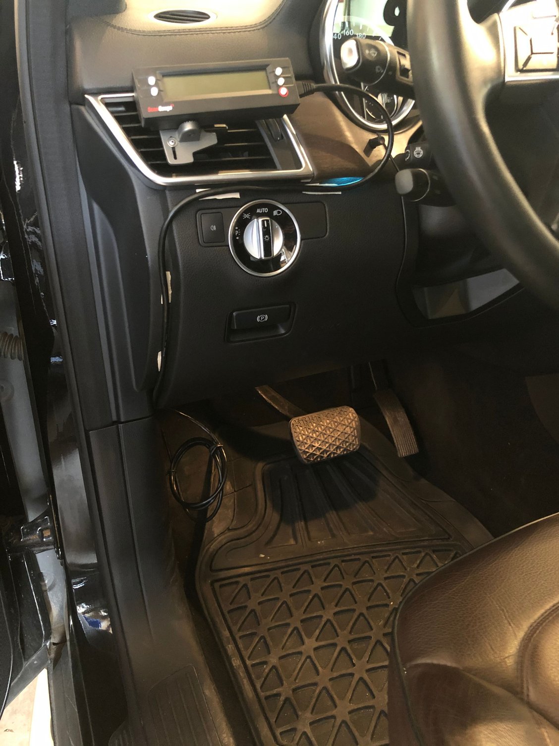

Where on the GL350 did you mount the Scangauge and route the cable?

I had a old phone holder that I modified for the gauge. I have it placed on the vent left of the steering wheel. As the cable connects on the right or behind I had to make a U and route the cable just underneath the vent and along the door supported by a double sided tape. I only had white coloured tape so I used that but I think I will eventually change it to black or transparent sticky tape to make it look better.
