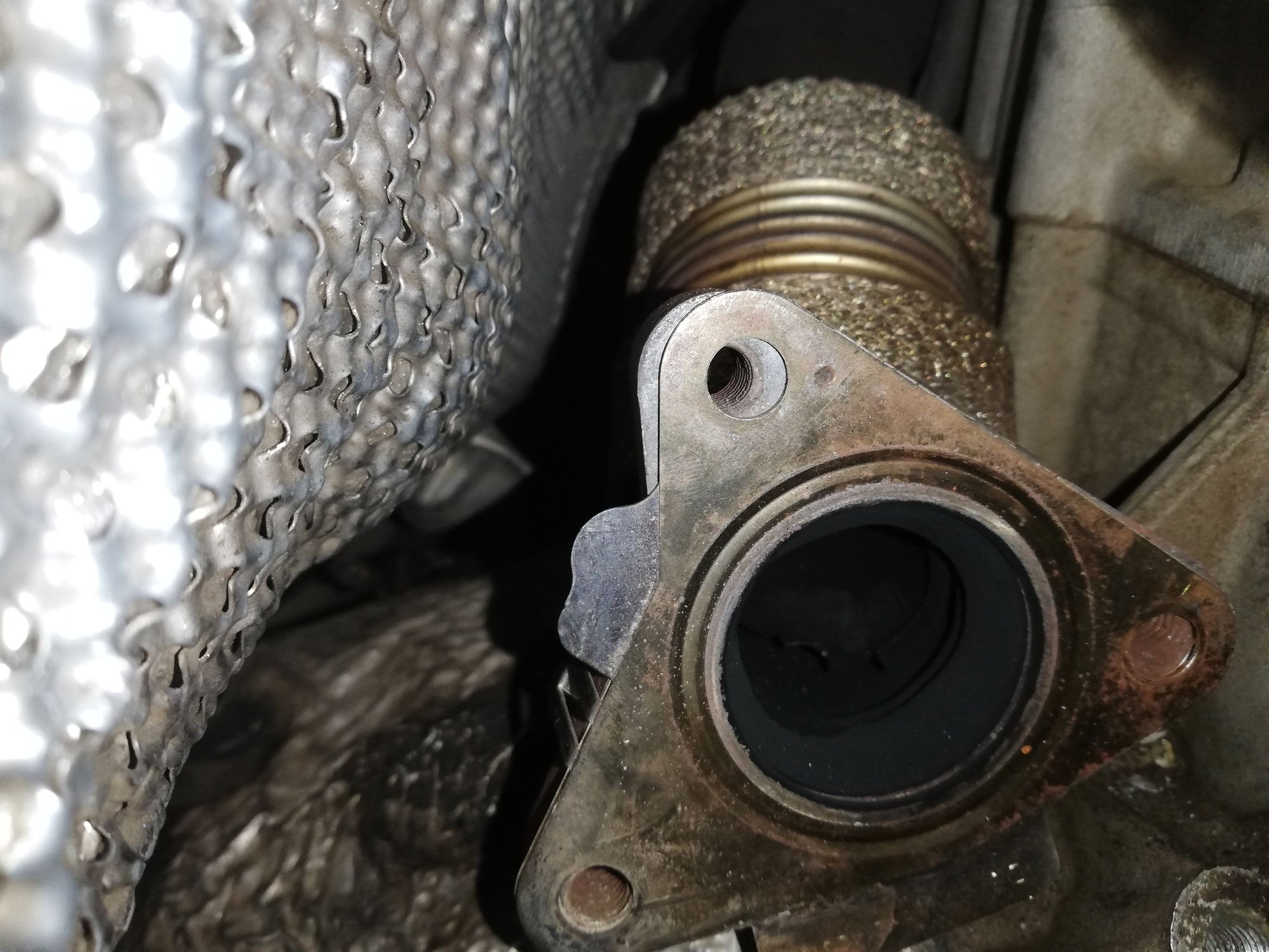

I found the problem. A piece of the metal pipe inside the exhaust manifold came loose and came thru the Turbo. Now the question is how on earth do I get this loose metal pipe out of the exhaust manifold?
I googled myself blue in the face looking for help how to remove the exhaust manifold on the left-hand side of the car.
Does anybody have a manual or pics of how to remove the left side exhaust manifold? I'm driving a W203 with a om642 engine and the space around the engine is not enough to swing spanners around.

Hi Kajtek1, see the pic's. The triangular flange is the end of the flexible exhaust manifold. The pipe inside that flexible manifold is what I need to remove.
The other picture is showing the heat shield over the exhaust manifold that I need help with to get it removed, so I can get the manifold off the engine.
The Triangular flange at the end of the flexible exhaust manifold

Attached is the breakdown from wis
Kajtek1, this breakdown is excellent. Thank you so much. I managed to remove the left side manifold. I will remove the right side tomorrow. Thank you Kajtek1, you are really a blessing.
