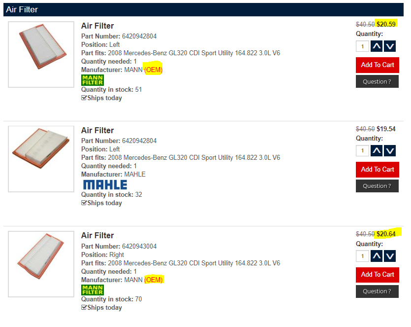

Air filters are $20 apiece and take approximately an hour to replace WITH the fuel filter.
Air filters get VERY dirty very quickly. Its amazing how many bugs they can suck in. We're talking needing replacement every 20k in a normal climate. More often if where you live is sandy or on a dirt road.

The picture I posted shows both filters from the OEM supplier (even highlighted) for under $42 total. Just because it doesnt come from the dealership doesnt mean its not OEM. Mercedes doesn't make filters. Its outsourced. Its the exact same product, but a different box.
There is no prestige in buying overpriced filters just because they come in a Mercedes box.

And stating they take 3 hours to replace and cost $60 each isnt misleading?

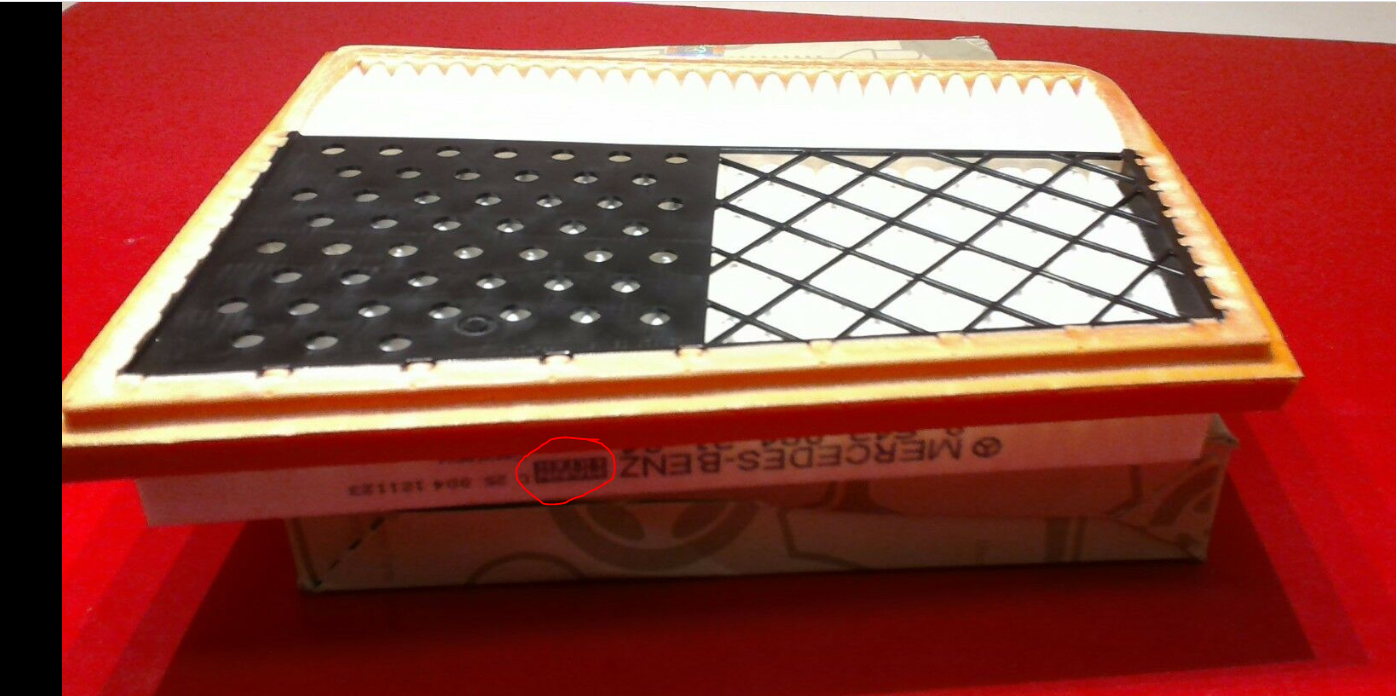

MANN makes the filters for Mercedes. OEM is exactly the same as OE. If you open your Mercedes air filter box that you purchased online or at the dealer, you will see a nice little MANN logo on them.
MANN LOGO ON MERCEDES PART!
For the claim that I'm misleading that the filter is only $20 and no mention of two, see my original post where I said they were $20 apiece:
Even if you buy OM642 filters in a fancy Mercedes box, they are $42 each. Not $120 for both.
Dont blame me for your lack of reading comprehension or understanding of how parts repackaging/rebranding works in the automotive world.
