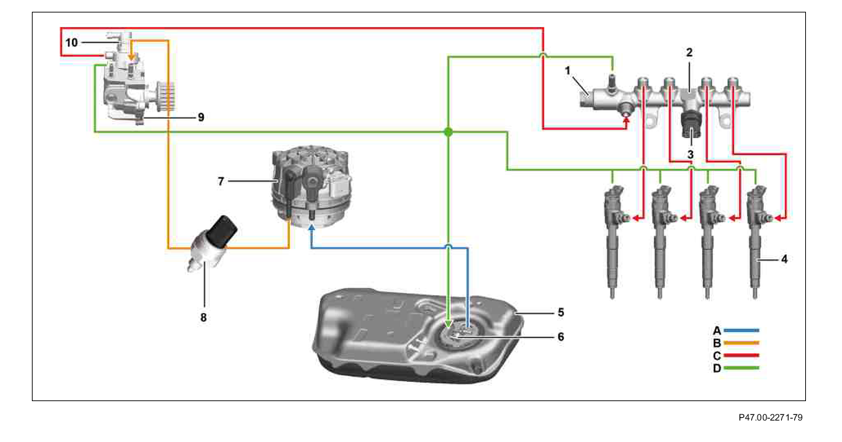

I don't think there's a one way valve based on the information I see from WIS. See below picture. As far as I know as soon as you switch ignition to ON the LP pump start working that will build a 70psi pressure in the system almost immediately as long as the fuel system is not empty. And as you start cranking the HPFP will build up at least 3600psi in the fuel rail to start the engine. This process is also immediate.
I know there's a pressure limiting valve (the part 1 on the photo) on the fuel rail that's controlled by the computer. Its function is simply to release the pressure after engine shutdown. That's the only valve I can find in the document.

I see. So what is this "fuel check valve at the fuel pump" in the tank this guy was talking about? As I understand, there will be a one valve to hold the fuel not to go back to the tank when you turn off the key.

Usually fuel pumps are designed with a check valve in it. It's meant to help maintain the pressure in the feed line so if your feed line doesn't have enough pressure you replace the pump then the check valve is replaced at the same time. No need to worry too much about it.

WIS document also says how much HP pump should return flow to tank in order to get siphon system work and transferring fuel in saddle tank from side to another.
If you read function of the system more carefully both 1 and 8 are controlling the pressure during engine run. True that rail valve releases pressure when de-energized.

Originally Posted by vaseto
I don't have the WIS, I can't see how much HP should spit out. Now here is what happened today:
So I got the new pump, replaced it and the pressure was exactly the same as the old one - 49 PSI. I think the gauge may not be accurate. So the old pump is good. Now, it turns out the fuel was indeed Gasoline, as B34chBum said. I think the ****ers from the gas station did something because I definitely did not pump gas in the tank. So I emptied the tank, flushed the lines, put 10 gallons of premium diesel. Tried to crank the engine. No luck, the rail pressure did not go above 43 bar. I used some starting fluid and the engine tried to run, but it died quickly. The pressure did not go over 43 bars. I Unplugged the control valve and the pressure sensor, still no luck. Interesting fact - after I used the starting fluid, the engine started cranking at 230-250 RPM. It was cranking at 185 RPMs before. So, what is next? Injector leak off test? I got a better scanner, I can see a lot of stuff now. Not sure what all numbers mean. I suspect one or both MAFS may be bad. But that does not explain the low pressure. Any suggestions will be appreciated.
First of all, I'd suggest not putting new parts until you are sure the whole system is clear of gas. If you pumped out some gas then lots of parts can be ruined.
It might be injector leak. This agrees with both that your LP and HP pump cannot build enough pressure. If there's leakage this could happen. The leak test can be done by disconnecting the return line from the injector and hook up a clear tygon tube and hang it vertical to the hood. Check this video
For your case you do not need the tube with marks. Just a clear tygon tube from hardware store will work. See if there's any leak with ignition ON but do not crank.
https://www.youtube.com/watch?v=iSp6I3OiaeQ
I got those, the whole kit. I will do the test tomorrow. Are you sure I can do the test w/o cranking? And why not cranking? Also, there is a weird code that keeps popping up - C42700 implausible data from the steering column and lock.
I meant that you first see if you see any leak without cranking, just to make sure the injectors are not leaking badly with even a low pressure (49psi as you said). You can also do this by unplugging the injectors and cranking -- that will give higher rail pressure and ensure the injectors are not actually leaking. Then you can crank and see the leakdown.
Theoretically the leak down test should be done when engine is running, so you have the normal rail pressure (~23000psi) and that will tell you how the injectors are working. For now what you need to make sure is just there's no injector leaking badly that's causing the rail pressure not building up.
