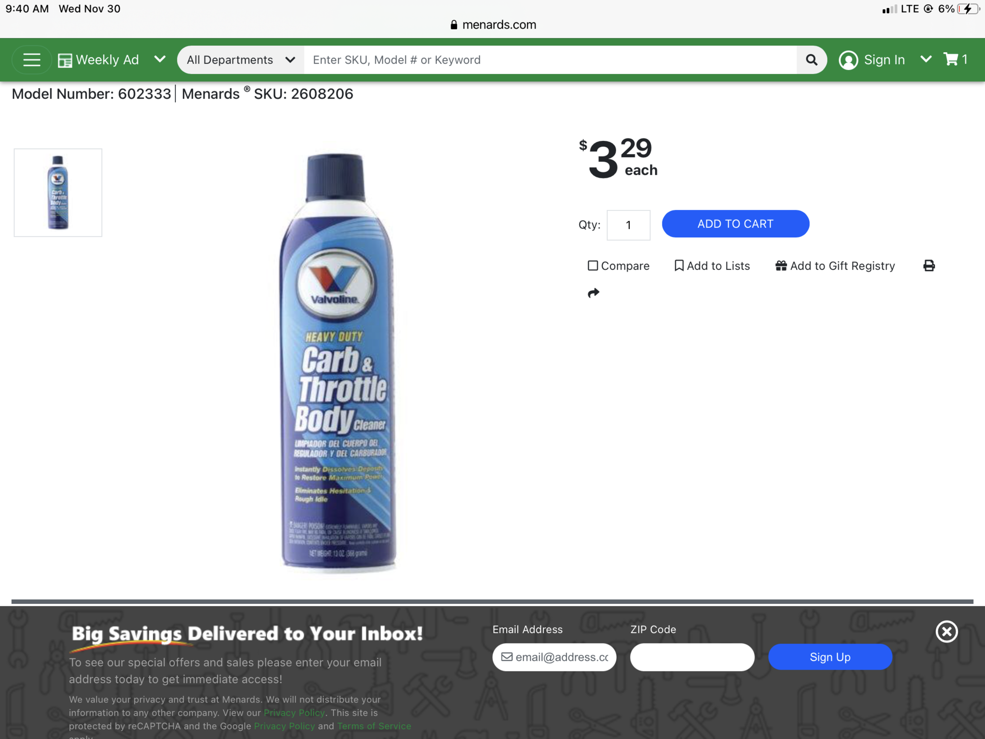

I would use Valvoline #602333 carb and throttle body cleaner, available at Menards $3.29 a can. Amazon wants $17 a can. I haven’t pulled any glow plugs yet but 602333 works super well on black death, I had two injectors in a very bad state, including wiring and piping, dissolved the tar with ease.
