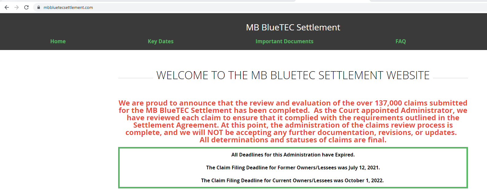

October 31, 2023 is the current deadline.
Settlement email
Old Oct 1, 2023 | 07:53 PM
300SE1993's Avatar
Joined: Apr 2003
Posts: 1,036
Likes: 277
From: Northeast
2012 S350 Bluetec, 2014 GLK250 Bluetec, 2026 E350 4Matic
Settlement email
Ah, OK. I didn't realize it was extended. The bluetec settlement website still has this:
