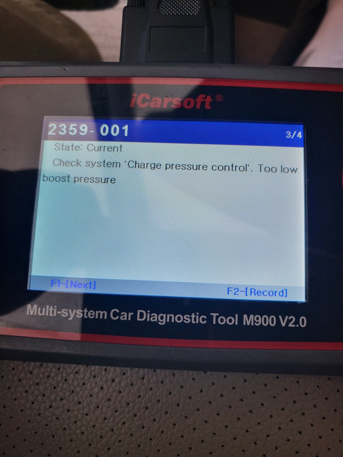

Hello everyone i have a 2008 e320 bluetec Anyone ever deal with these codes? I have generic turbo underboost code along with p0428 catalyst temp sensor bank 1 sensor 1. Also have 2 more specific codes below. What is the boost control throttle valve? Isnt that part of the intake elbow?

Confirm that you check all intercooler hoses for leaks. That would show as oil stain around.
The scanner shows 4 codes in memory, when you show 2 ?

One intercooler wasnt snapped in all the way, the charge pipe to silencer was loose and the o ring was broken. I corrected all that all that i have zero boost . I only posted the 2 more specific codes, i also have p0299 turbo underboost and p0428 catalyst temp sensor. But what i really really want to know here is about the code 2940-001 BOOST CONTROL VIA THROTTLE VALVE CLOSED MAJOR. I mean is that part of the turbo? Or is that part of the intake elbow where a throttle valve actuator exists?
