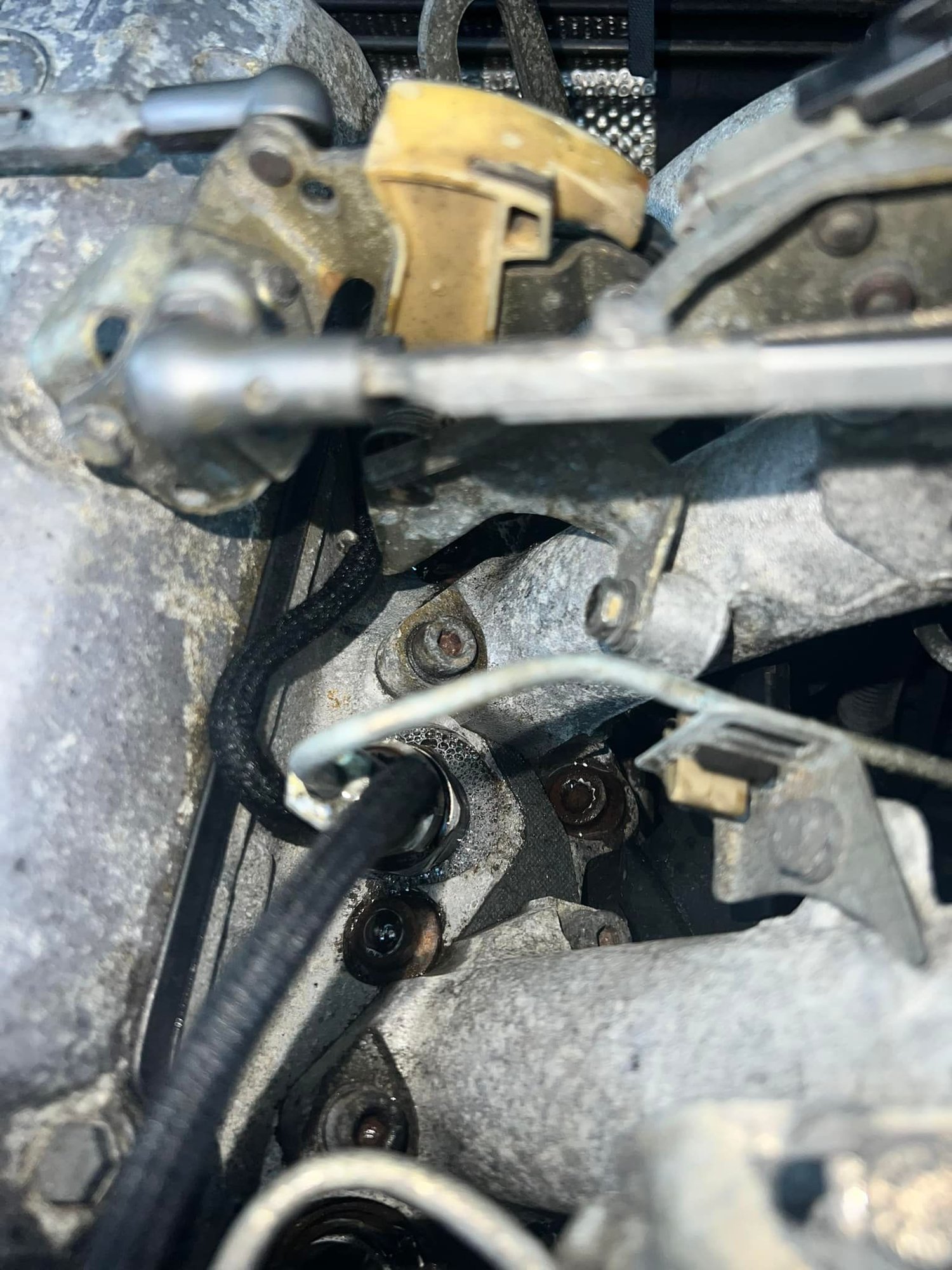

I have repaired nearly every problem with my engine, and I'm now at the last issue. Persistent nailing and smoking. I determined that the issue has to be caused by incorrect timing or low compression.
I found that all 5 prechambers are leaking out of the head when sprayed with soapy water. Cylinders 1 and 5 aren't too terribly bad, but 2, 3, and especially 4 are leaking bad enough to lower compression. There is rust and corrosion around the locking rings above the prechamber and some oxidation and corrosion in the holes themselves. So it's definitely crept down between the prechamber and the head. The procedure to repair this is somewhat difficult and requires a special Mercedes reamer tool, as well as shims installed. Dealer says that shims are NLA.I have the spline drive tool for installing and removing the locking rings coming, and I want to make one last effort to tighten those down before I make the diag on this issue final.
Any suggestions to address this?
Note the foaming around that injector. This is with the engine hot. When cold, it's much worse.
