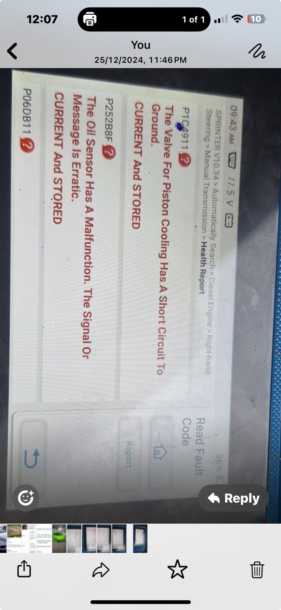

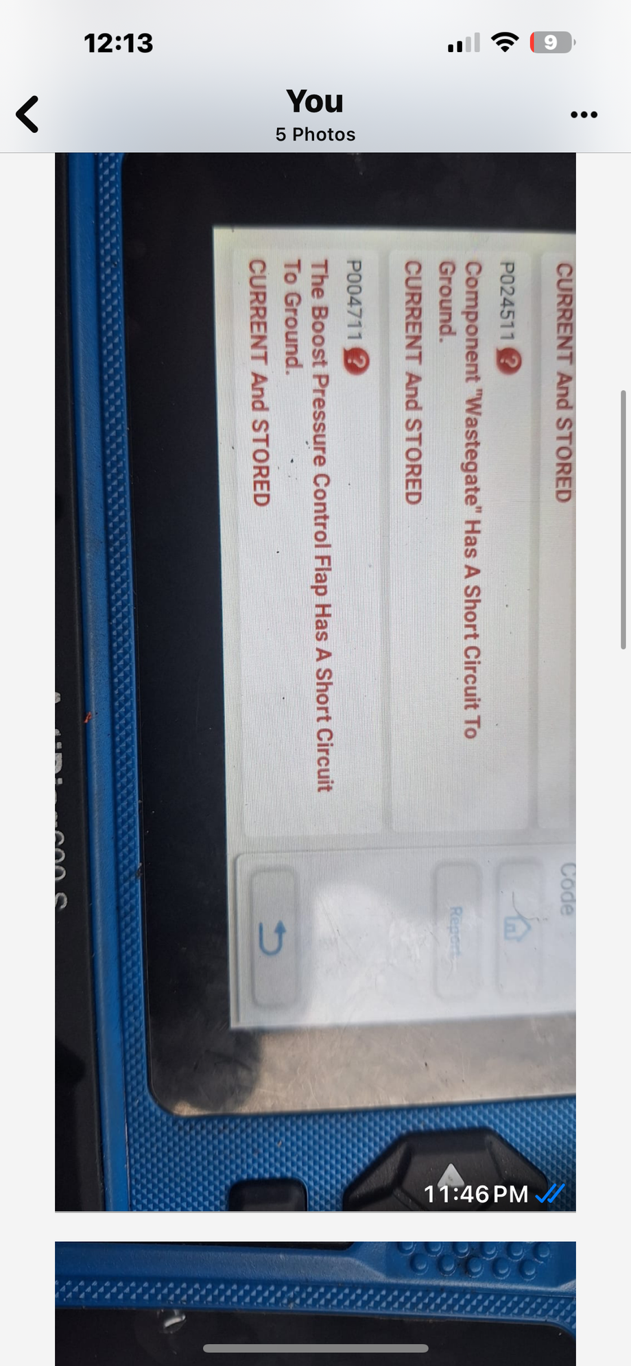

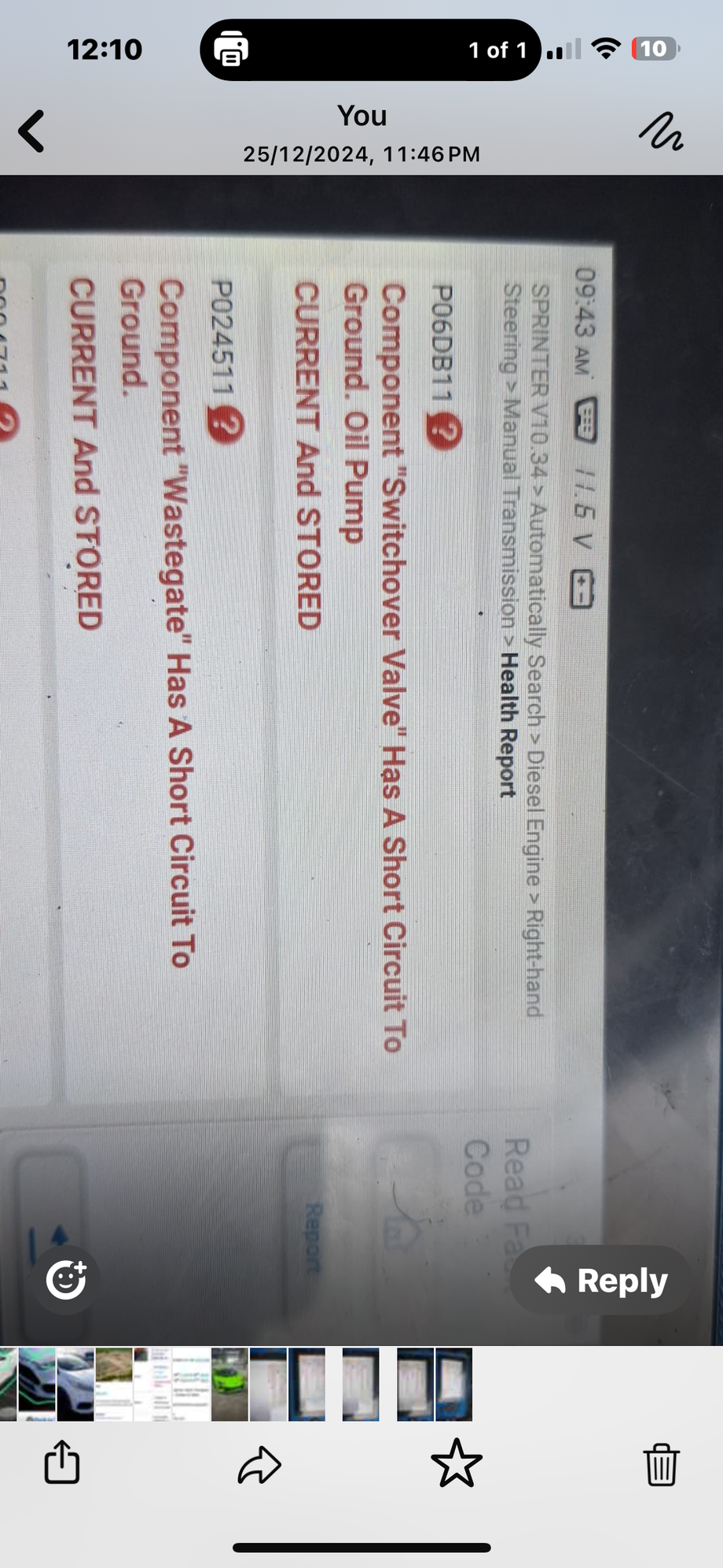

Hello members
I have some faults codes that I’m trying to seek some guidance on I did try to request help in the sprinter forum but got no reply

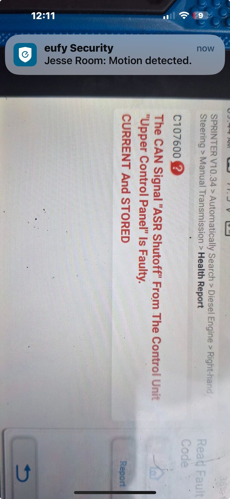

I see many are related to earthing but it also picks a comms issue for a module however when I scan that module it doesn’t return a part number or software hardware number like all
the other modules therefore I can’t find out what module is not commicating and I believe that can trigger the other issues
if anyone can look over the fault codes and provide anything would be greatly appreciated
Ryan P004711
The Boost Pressure Control Flap Has A Short Circuit To Ground.
CURRENT And STORED
P1C4911
The Valve For Piston Cooling Has.A Short Circuit To Ground.
CURRENT And STORED
P252B8F
The Oil Sensor Has A Malfunction. The Signal Or Message Is Erratic.
CURRENT And STORED
P06DB11
Component "Switchover Valve" Has A Short Circuit To Ground. Oil Pump
CURRENT And STORED
P024511
Component "Wastegate" Has A Short Circuit To Ground.
CURRENT And STORED

Not likely 5 sensors failed at the same time.
More likely a plug got loose, or wires damaged.
