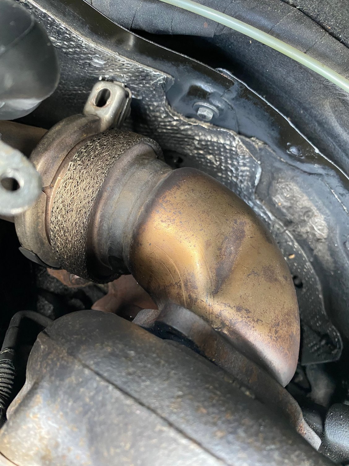

Looking for some more help on this one. I have everything out except the turbo itself. The exhaust pipe that comes out of the back of the turbo, does that come in two parts? It’s in the way of one last bolt that I need to reach. Any help would be greatly appreciated.
