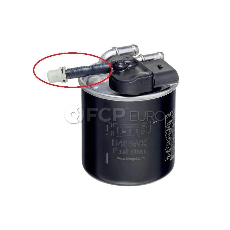

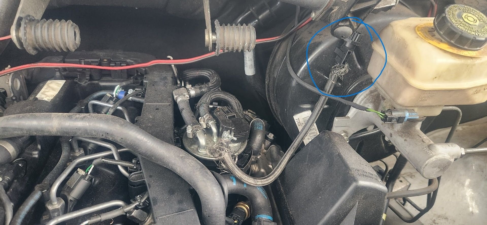

Where is this line need to be connected people?

That is the bleeder valve for the filter. It looks like someone cut the valve off the filter and reattached it with that hose, probably to make it easier to use without making a mess. It doesn't connect to anything.

I think you will find my answer is correct. The two metal elbows are the inlet from the tank and outlet to the high pressure pump
Besides, the car wouldn't run if one of them wasn't hooked up. (or is that why you're asking?)
