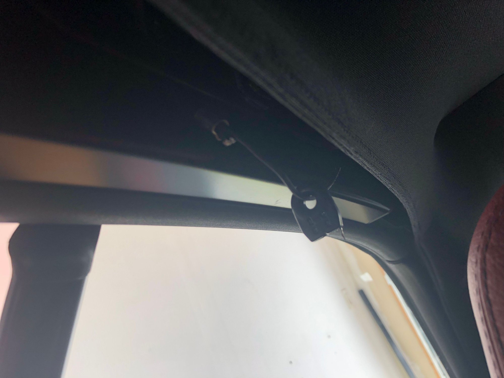

Hello, friend, I recently noticed a broken part in my soft top, and last time I closed the roof there was a weird cracking sound, should I take the car in for an inspection?
Image of the part I found is attached, any thoughts is appreciated.

We have the exact same failure on our 2013 E Cabriolet. It has been this way since we purchased the car as CPO in 2016. I believe the purpose is to pull a portion of the inner soft top up during the folding process while lowering the roof but we haven't noticed any issues ignoring it for 3 years. The loose plastic does cause a rattle though... On my to-do list is to see if I can re-attach based on looking at the same part on the other side of the roof. Would be interested in hearing what the dealer says if you do take it in.
