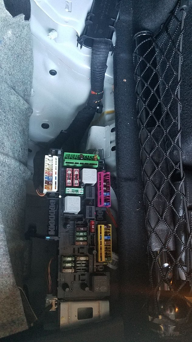

If you have an auxiliary battery ("additional battery") it is under the rear luggage floor adjacent to the spare tire.

Just checked and I do not have an aux battery.

Has the starting (main) battery been changed during your ownership? Do some searching and you will find low battery (aux or main) can cause problems with HOLD.
Other than replacing the battery, the next step is to read codes with a M-B specific code reader. Or take it to an indy shop or dealer.
