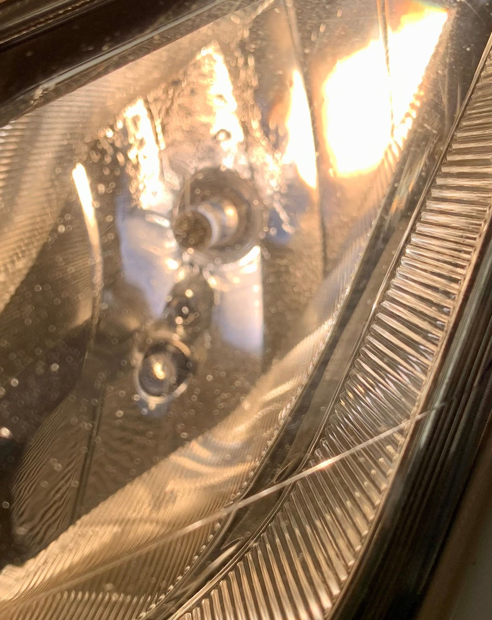

Originally Posted by Harold1898
Agree that LED produce very little heat.
this is the headlight assembly. I’ve since gone ahead and replaced the high beam bulbs with halogens but notice the damage from the LED bulb. I agree that the bulbs themselves are cooler but the area at the bottom of the bulb is not. The low beams (still LED at the moment) have fans to cool the heat sink assemblies and I was told that the sealing caps for the headlight assemblies must be left off to keep the heat sinks from overheating.
