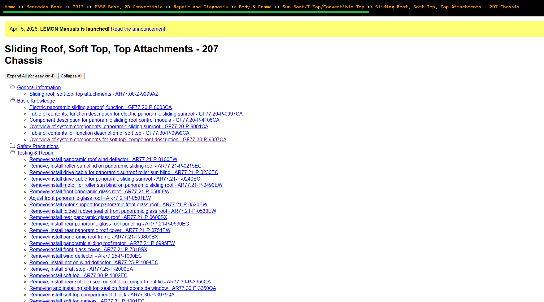

Heres a link to the online manuals for the soft top. https://lemon-manuals.la/Mercedes%20...207%20Chassis/
When you open the link above you can click the tabs I underlined in green at the top of the page of the photo below to navigate the different sections.
