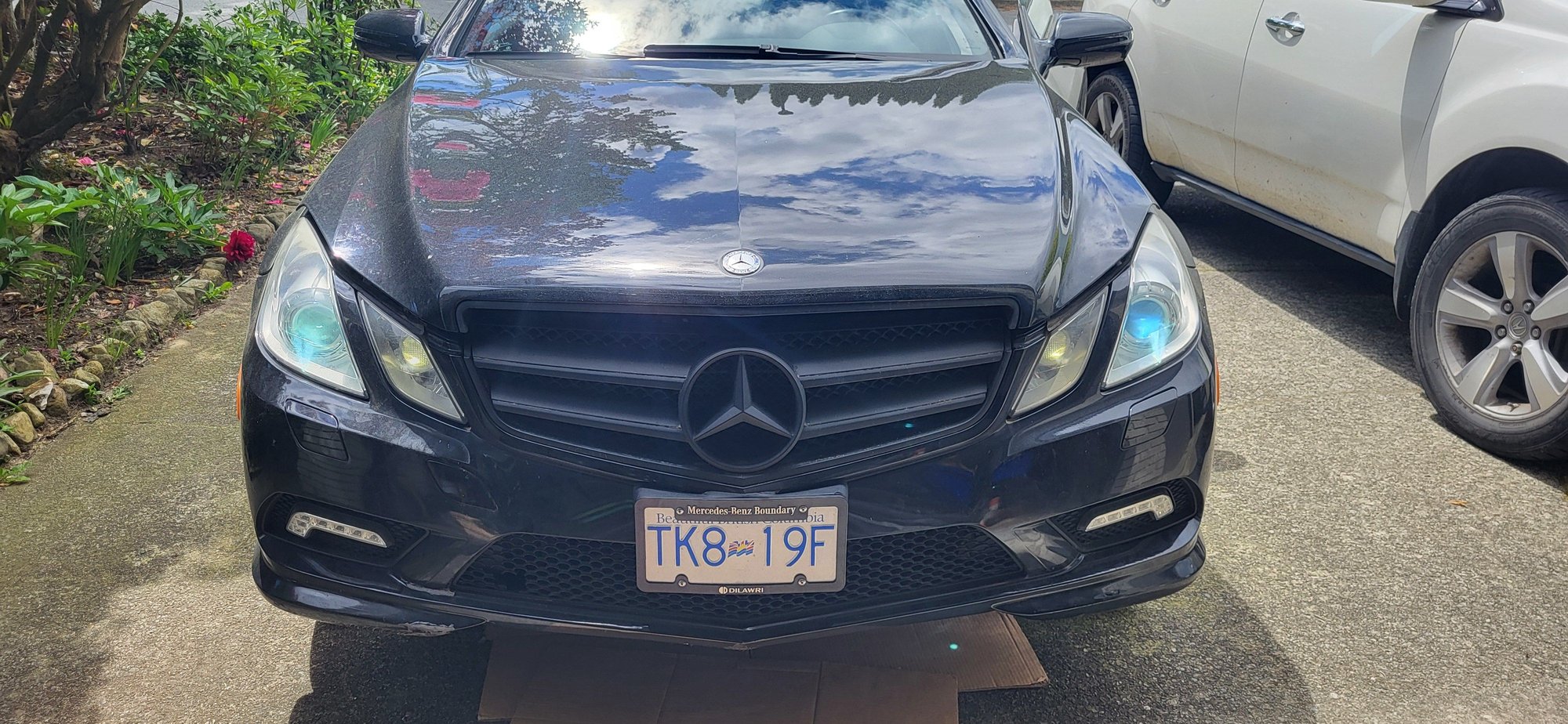

Hey,
So I had been having some headlight issues...
the right headlight started to work intermittently and now has ceased to work at all.
Low or High beam.
Left headlight is fine.
I swapped bulbs from right to left and no difference. So bulb is not the issue.

Ordered a replacement.
Left light out

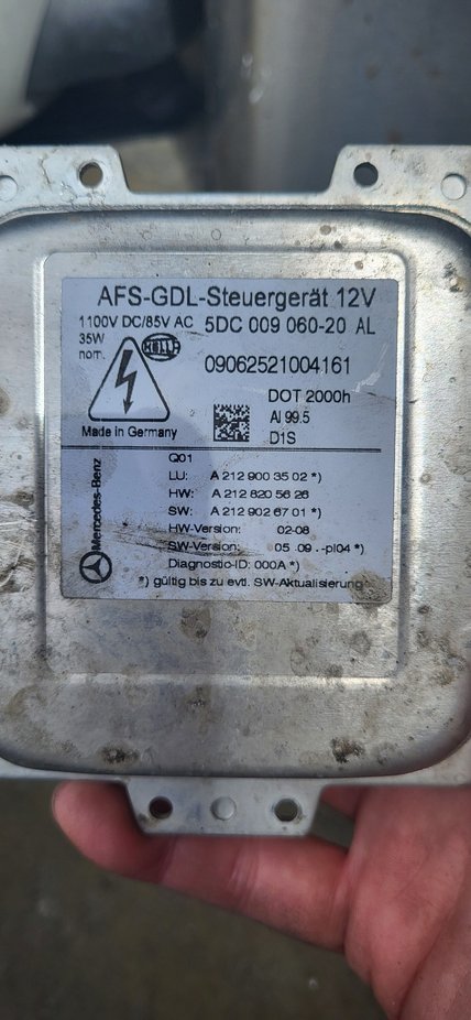

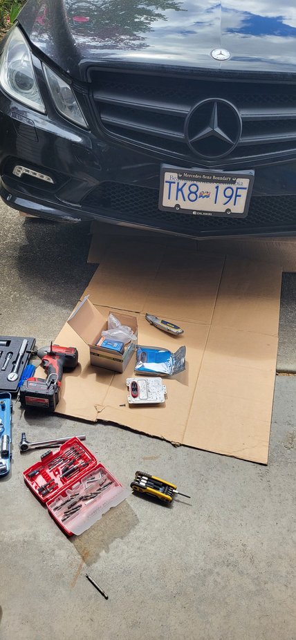

removed old ballast, need to remove bottom cover held by nuts 5/16th if I recall correctly, and ballast held with 2 T20 torx.

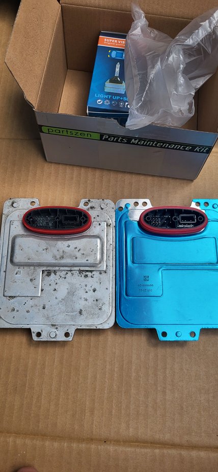

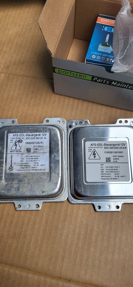

ballast connector side
ballast top

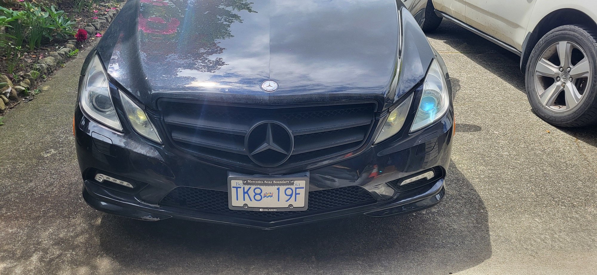

Success! Lights aren't blue, they are white, but burn blue first few seconds upon turning on.
