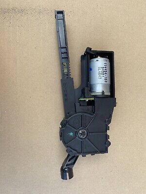

I have 2010 a207 e250 cgi cabriolet with full memory seats. I want to change the headrest motor but i can't get it out of it's place and i don't wanna break anything... can anyone one help me and tell me the right way of removing the motor from its bracket.

See attached and let me know if this helps? I may need your VIN# to provide 100% accurate info. Happy to share other WIS files if needed?

thank you but unfortunately that's not what i need...
I want to know how to remove the motor from the frame of the seat.

Apologies, was a bit sleepy...see if this better suits?

tha k you soo much for your efforts.. i managid to remove the motor.. there is a metal clip that u have to bend down in order to the motor to slide to the side.. after i installed the new one.. i bent the metal back to it's original place so the motor won't slide out of it's bracket..
