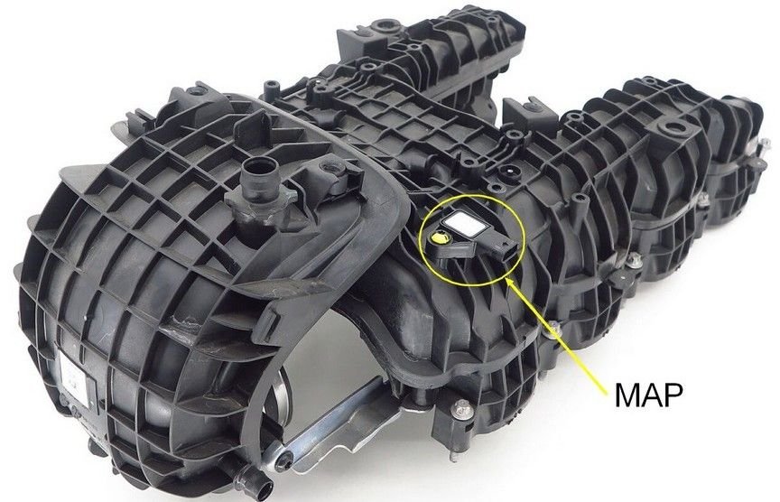

Sounds like your MAP sensor is bad so it can't give the correct fuel to start easily.
I'd say use an app or device to see what the static pressure of the MAP is, and the cam positions at idle, so you can see if the faults are real, and what/where needs attention. The MAP sensor should be both cheap and easy to fix (per pix). The cam code is likely a sensor, and even easier to replace.

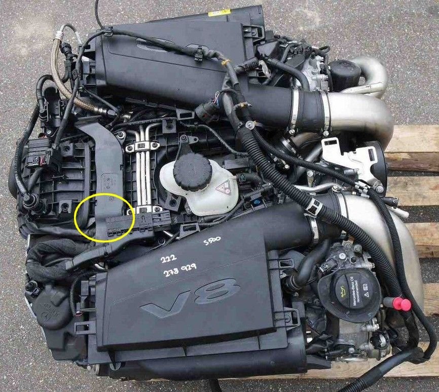

I don't suppose you check for oil in your ECU harness? If not you need to because that can cause a variety of issues, and maybe yours. Your age and mileage made think of it. If unfamiliar, it's a common issue with these engines. Just search here for "oil in harness". I also posted a fix for it here: https://mbworld.org/forums/gl-class-...ml#post8771425
