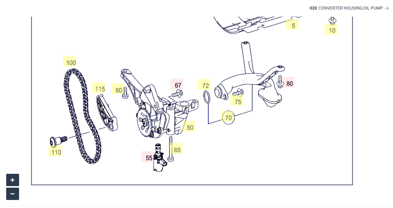

As I am currently going through the forum to look for info as far as I understand there are check valves for each valve lifter/ cap (?) and supposedly 2 in the oil galleries, 1 being under the oil cooler housing (?) and one on the oil pump (?) but I am completely unsure. I kind of rule out the valve ones since the rattle sounds erratic and less organised/ timed as it should be with lifters. What I'm seeing on the oil pump looks more like a pressure solenoid rather than a return valve and even if it is it seems unavailable where I live since its marked out. I can't find anything on parts schematics under the oil cooler housing. What I have read on here is people having issues with the No 72 O-ring aging / cracking and causing similar issues. Still looking for info since I dont't want to pull the oil pans more than once.

#55 in the pic is the oil pressure solenoid. it was designed to reduce pressure under ECu control at certain rpms,,like 1000 -3000 rpm. This was ONLY for helping increase the MPG of the car(s). Please see the huge oil control solenoid thread on here for more info on that.
I could see #72 being an issue but not intermittently. you would get low pressure all the time.
You may have to remove the oil pan to chase this down. If so then I would replace the oil control solenoid for sure while in there. FYI if the oil solenoid failed it fails in the high pressure mode. so unlikely the system is low pressure...it is far more likely to be the check valves for the camshaft tensioners.
Did you look for the threads on that?
