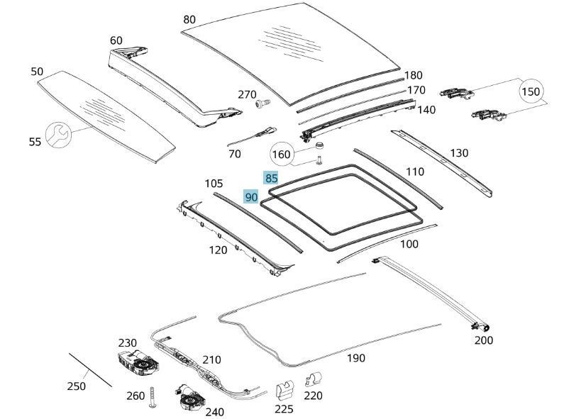

Assume MBS63AMG is referencing following also attached instructions for cleaning & lubricating.

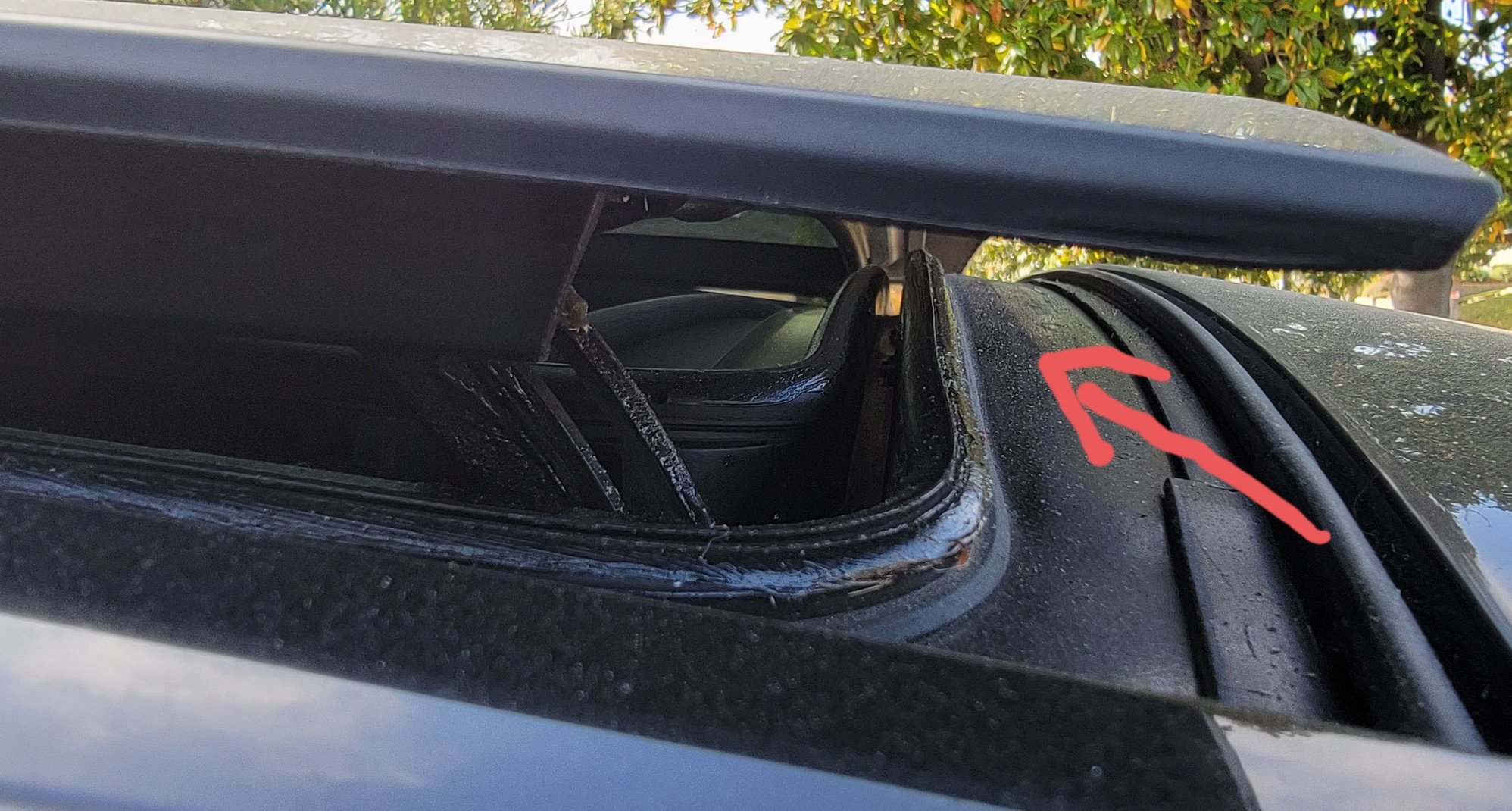

bit dirty here but this rubber lip is what I lubricated

will do... which product did you use?
Old Nov 11, 2021 | 05:54 PM
C280 Sport's Avatar
Joined: Jan 2009
Posts: 3,830
Likes: 594
From: NY & FL
MB’s of all kinds.
Use Krytox lube. It’s expensive as hell but it works great!
