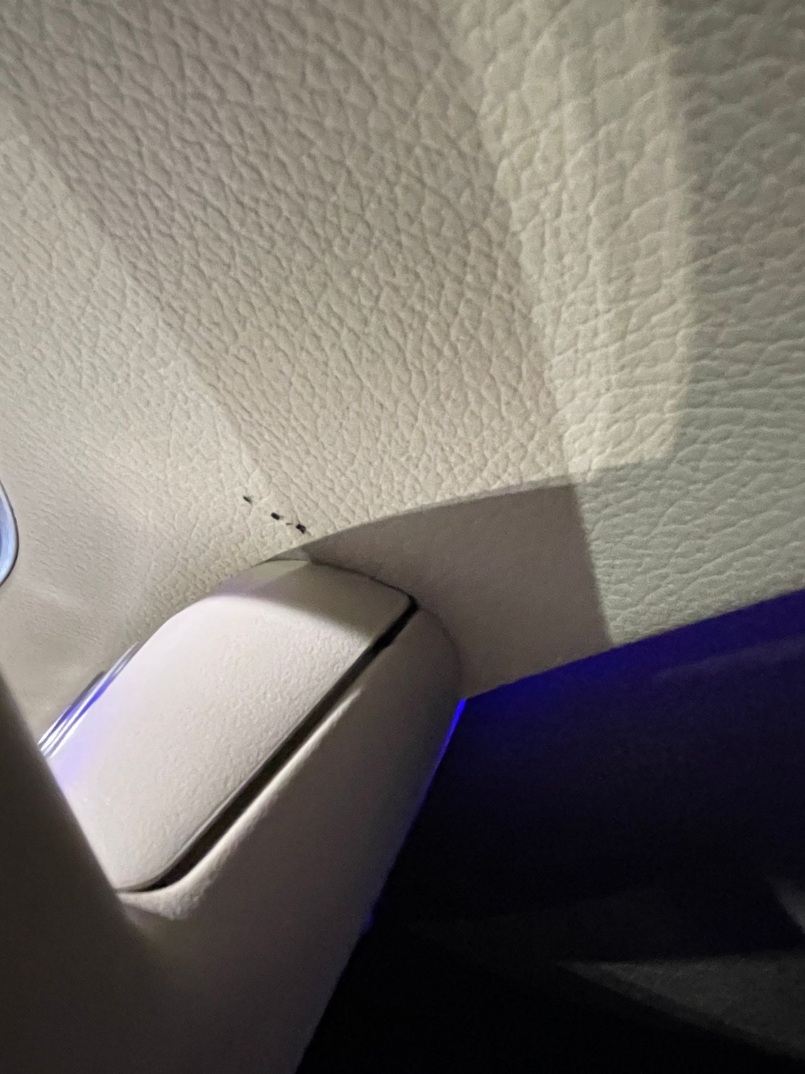

First post here so go easy on me. I purchased a CPO 2018 E400 4Matic coupe with 12,363 miles. I LOVE THE LOOK of this car and the interior is beautiful. But after driving a little over 1300 miles I notice the doors make soooo much squeaking and creaking noises it driving me crazy. with the softest touch it sounds like you are eating chips and I have this weird rattling noise coming from the rear interior roof. I took it to the dealership and drove one of the service guys around to confirm it and they took it in for service . Ive test drove other e class and have a 2020 GLE loaner vehicle and none of this is present. AT 34 this my first Mercedes purchase and as I said I love the the look and how the car drives but hopefully the can resolve this because this is not acceptable for $79,000 luxury vehicle

Yes I have a pano.. but the noise is coming from 2 places in the rear. The first noise I noticed came from the rear passenger seat belt, I believed it’s the bearing where you pull the belt. The second noise is coming from the rear roof area I think it’s the rear roof light

Here’s the first resolution.. I still hear the rattling noise
And here’s the second remedy.. Notice how they say “noise is no longer present at this time” now I will admit the noise on the driver door is better but it’s definitely still present. Now the passenger door sounds like the did nothing and to top it off I noticed that they damaged my driver door leather

I added the photos

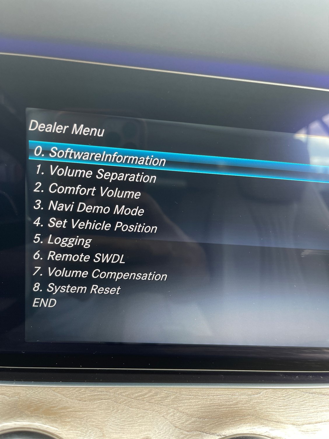

The setting may be in either the Dealer menu or Workshop menu. My car is in for service for A service and to address the rattles and have a 2021 w/MBUX loaner so can't check myself at the moment. If you have issues accessing these try searching the W213 forum for specifics.
Dealer menu:
Home, highlight but do not click on System. Press and hold the scroll wheel for 10 seconds

Thanks for the help. I tried following the steps but it didn’t work .. 1 I press the home key on the console highlighted system press and held the scroll wheel for 10+ seconds and nothing happens. I don’t know what I’m doing wrong

Try the same steps but highlight Vehicle instead of System, press and hold scroll wheel for 10 seconds. If that fails, search in the 213 section as steps may have changed.

That’s what I did after I tried the system highlight.. but this is what showed up.. since I didn’t see the other steps listed as options I figured I was doing something wrong so I exited out. Here’s the selection that are listed. Thanks again.. oh and how do I get to the213 forum section if you cannot help with the listed options

Doesn't look like Dealer menu is the right one then. The Workshop menu steps provided are separate and actuated using the buttons on the left side of the steering wheel and interacts with the gauge cluster display. To get to the W213 section, go to Forums, Sedans, E-Class (W213). W213 is the sedan version of our car, both share the same platform.
