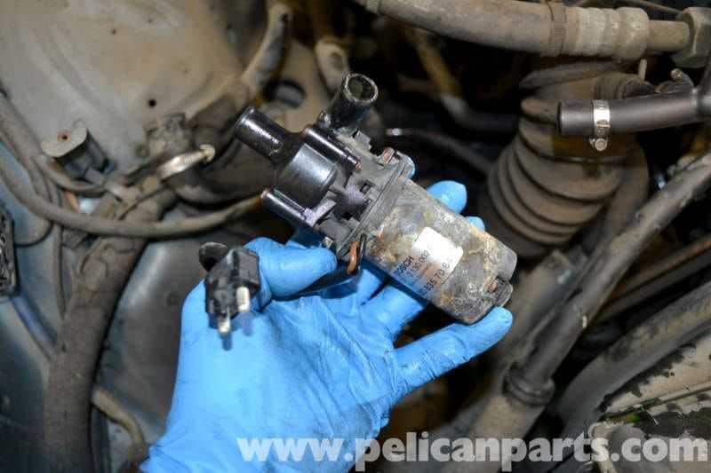

Marken this is the secondary coolant pump, Or thermostat stuck . There is another part that it can be,, the heater valves .These can be rebuilt with a repair kit .Feel the coolant pipe that goes in to the heater valve, the one going in should be hot after the car is started for a few mins after coolant as circulated and the thermostat has opened up. the hot pipe going in to the secondaty heater pump should also be hot . So if all hoses are hot right up to the heater valves,, and you still dont have hot air in the cabin this points to the heater valves problem .I will post a picture of heater valves .

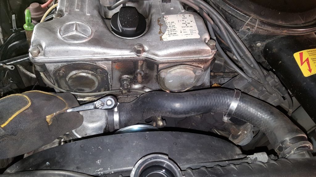

Marken the heater valves are nor worth replacing with the parts . its best to replace them for a new unit . Pic of thermostat location... and the heater valve id
