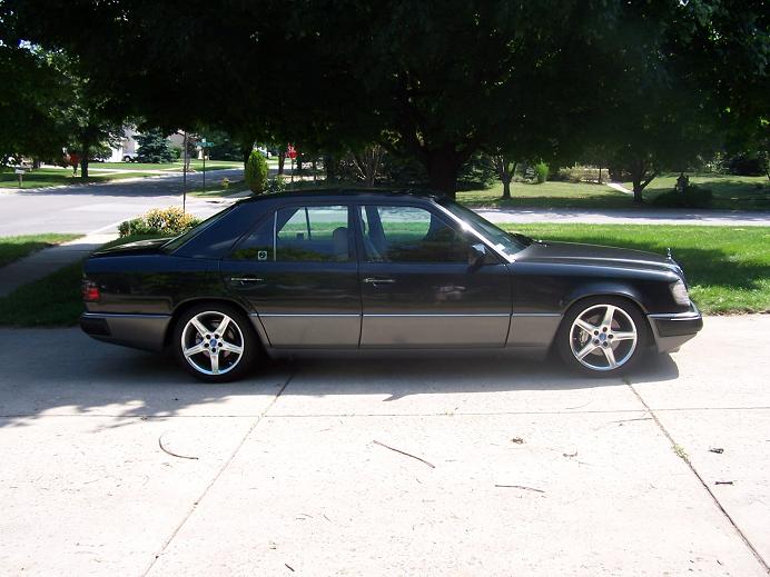

Before you get into cutting springs, I'd recommend putting on the springs with the smallest spring pads. Maybe look into Vogtlands, seeing as how they lower a little more than the H&R's? If the car still doesn't sit low enough for you, then maybe just use a thin piece of rubber for the spring pads? That will lower it further. Your last thought should be cutting the springs. It's the only thing you can't undo. I doubt shocks will suffer too greatly, as long as you run shorter, sport shocks.
The car will go just as low on 18's as it will on 17's, as long as the tire diameter is conserved. I'd actually think the car would appear lower on 18's, just because of a perspective thing.
Check out my car. It's on vogtlands, with the lowest spring pads in the rear and the 2nd lowest up front. 17's. The front tires are already tucked inside the front wheel wells. On 18's it would look pretty crazy low.
