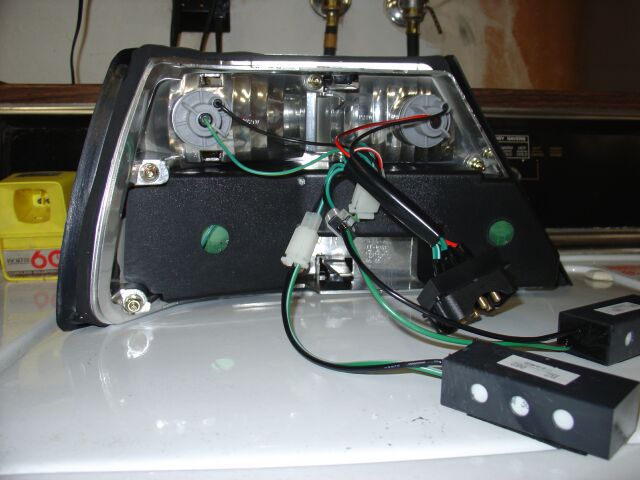

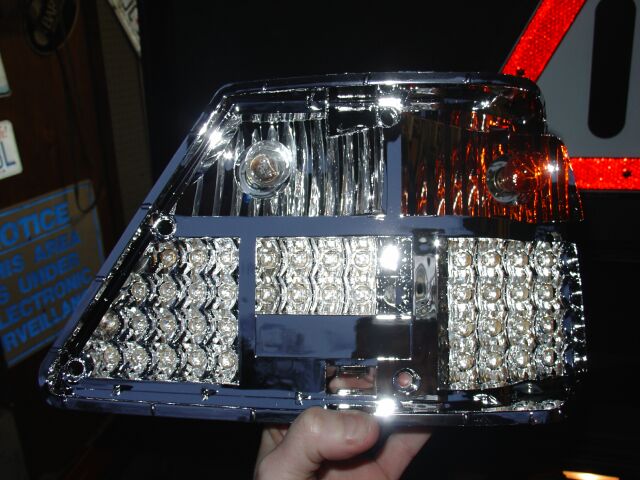

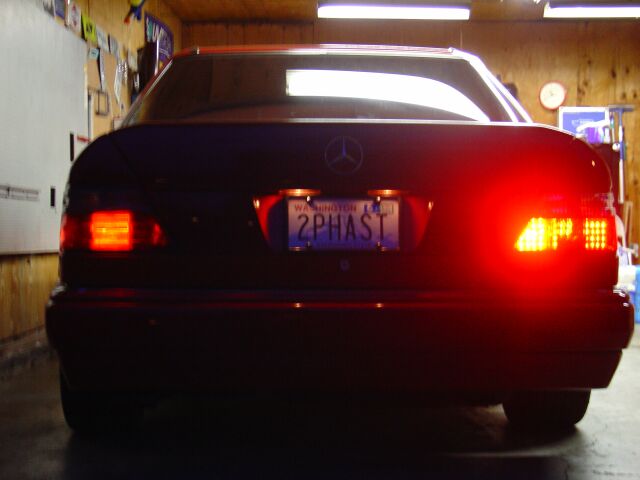

Couldn't wait for the weekend to install
The left is the regular tail light, the right is the LED light. No bulb out indicator either, although on the drivers side, because of the rear fog light, the connector is different then the passenger side, had to take it apart and plug the wires in one at a time.

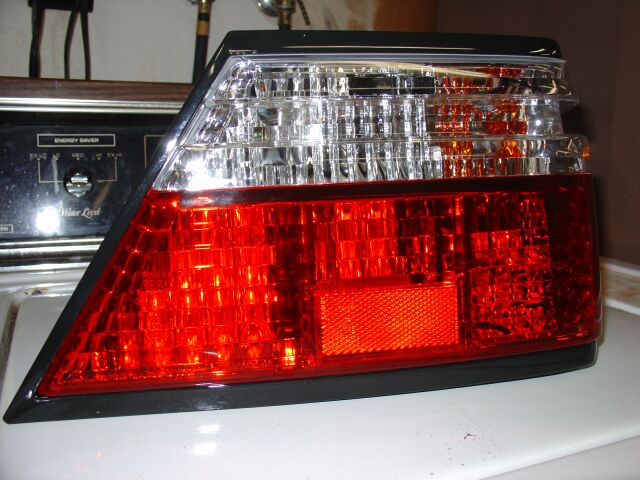

What you see on the right is the regular running lights, the brake lights are a bit to the right and are just as bright. There is no provision for the OE rear fog light, so I just taped off the extra wire for it.
I like these lenses better than what I had on the car.

1. Ebay.
2. Great light output and great build quality and fit

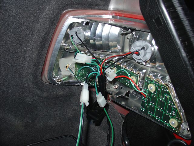

3. Passenger side is plug and play, drivers side is not, you need to order a passenger side 6 pin connector, then take your 8 pin connector apart (on the drivers side) and move all the pins (except the rear fog light) over to the new 6 pin plug.
Only complaint is the fact that your existing back cover will not fit on these lights, leaving the rear and wiring exposed.

The drivers side, tail light harness plug (8 pin) needs to be replaced with a passenger side 6 pin harness plug. Takes about 10 minutes max to replace the pins 1 to 1, then you leave out the rear fog light pin (you lose rear fog light cabability) and tape it up.
These lights probably are not legal in europe or countries that require a rear fog light, so keep that in mind.
