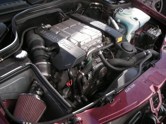

He is referring to a enclosed box like this one in my CLK. It isolates the filter from the engine and help prevents it from sucking in hot air. (This is no longer in my CLK, I replaced it with a factory C36 intake system)
