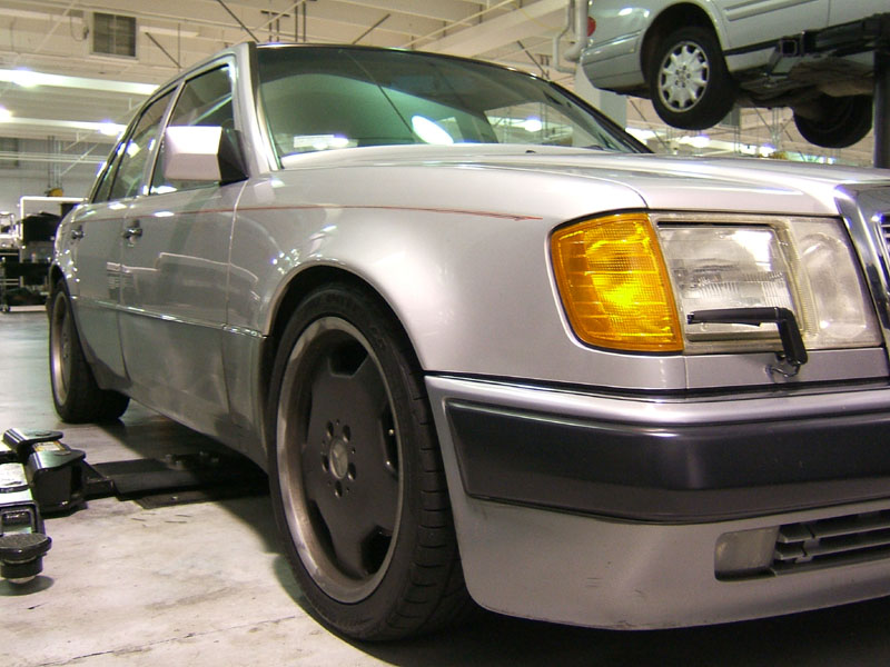

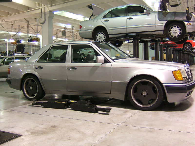

I like mines, I am running w210 E55 wheels, but without the 500E flares I don't know how you are going to tuck them. I can't remember the offset 35/32 maybe, but they are 18x8 and 18x9. Big heavy wheel for a 320 you will definitely feel them when you are trying to brake :p I noticed how heavy they were the second I put them on the 500, but they look so damn good. I want pics and details if it works!!!!

500E is way different than the coupes and regular w124 cars, it has r129 suspension and huge fender flares. I can run 265 in the front and 295 in the rear from what I have seen others do, right now I am running 245/40/18 and 275/35/18 but there is no way that will fit on a coupe without major modding. 500E "stock" ride height i hear is like 1" lower than a 300E. With the right off sets you can run 225/45/17 and 245/40/17. Also the over all wheel/tire diameter on the 500 is greater than the other w124, it uses SL and S wheel/tire sizes. For your speedo to still be accurate you if you wanted to run my widths, you would need 245/35/18 front and 275/30/18 rear. I don't even know if the rears will fit on without hitting the shock with the wheel because of width and offset. I am looking at a coupe and I am going to run 17X7.5 wheels with 225/45/17 tires I think.
See if you can tell from these pictures the flare I am talking about.
-Mike
