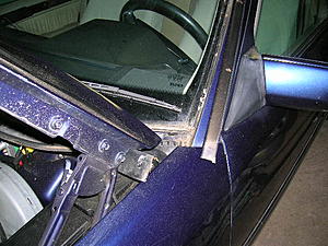

Hello every one. I am having a little rust problem with my car on the pillars and I was wondering how I can get the trim off? I there a special tool I can buy or is there a way to take it off? if I take it off and in the process I damage it can I buy this at the dealership?
on to the pics.
these two are only on the passengers side, but both sides are like that.
I want to fix this before it gets worse. Thanks in advance for all the help.
-cesar.

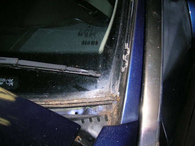

ds190's Avatar
Joined: Mar 2007
Posts: 169
300TE, 300CE
Just unclip it is the actual answer
1. Open the hood all the way straight up.
2. Pop up the rubber molding at the bottom of the windshield, and move it a few inches away.
3. Fingers under the trim piece a few inches up from the bottom corner of the glass, rock the trim as you lift upwards, and it will pop out of a clip. Watch the bottom as you have to move it around the fender to not scratch the paint.
The entire trim piece is held in place by clips all the way back to the rear window. Both sides are always removed before replacing a broken windshield.
Fix that rust soon because the more it rusts, the harder the repair. I have a 2 cm long rust bubble on the roof right at the top of the windshield on my E300 to deal with. Rust suxs.
Attached Thumbnails alittle rust.-dscn4232.jpg   alittle rust.-dscn4233.jpg   alittle rust.-dscn4234.jpg

So I took off the strip and grinded/sanded the rust off, bondo'd it a little and primed it. I just have to paint it and she'll be ready to go. Lucky me it wasn't so bad of a rust problem. thanks for the input everyone.
