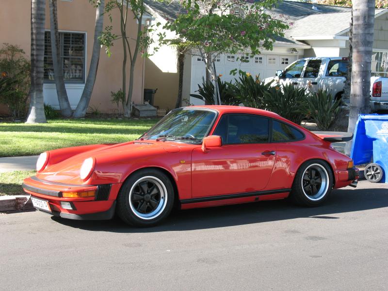

Hey Ronald...I'm changing out my rear pads too and need to rent your compressor!! Why don't we have a spring pad party in socal and do it at the same time...rental fees still apply
btw I just got done lowering my 911...got stiffer torsion bars and had to re-index them and then corner balance the car....its a ton of work...coil springs are a lot easier to deal with.
