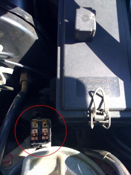

I also have a fuse question. There is what looks like and auxiliary fuse box next to the main with spaces for two fuses. However, the spots are empty. There are also two clipped wires in the main fuse box. I have heard somewhere that there was a conversion to an external box for some fuses on the w124. Does anyone know what the external fuses are for and what amps fuses it should take. Is this box somehow connected to the clipping of the wires in the main box. I have attached a photo of the fuse box and wires.

I believe those two are for the theft alarm unless you have another pair of fuses next to all the relays above the fuse box.
http://www.peachparts.com/shopforum/...4&d=1243511924
