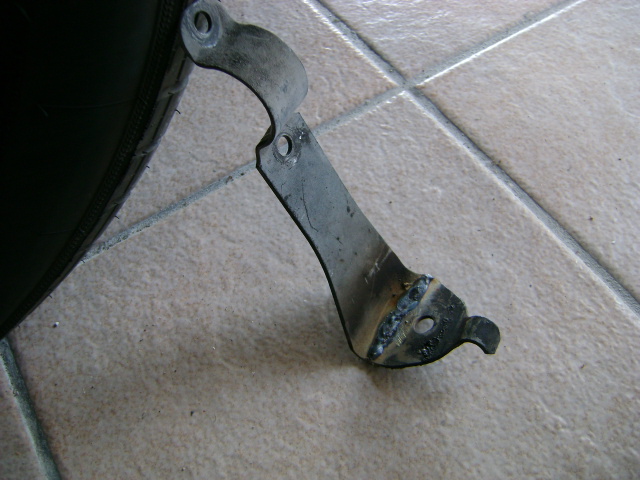

Went to change my shocks out today, rears first, then did the fronts. Hmm, rears don't seem bad, maybe the fronts are old? Got the drivers side off and changed, hmm, that one don't seem bad either. Pass front, hmm, look at that sway bar eating into the plastic dust shield, wow, broken bracket. Didn't see that when I was looking around earlier. So needless to say I just replaced my Bilstiens for some "good" Monroes, oh well will keep the stiens for S&giggles.
Stopped at a local Italian muffler shop on the way home and he welded up the bracket for 5 euro (7 bucks), he also wants me to bring him some american smokes Monday, cool, maybe I made a friend.
