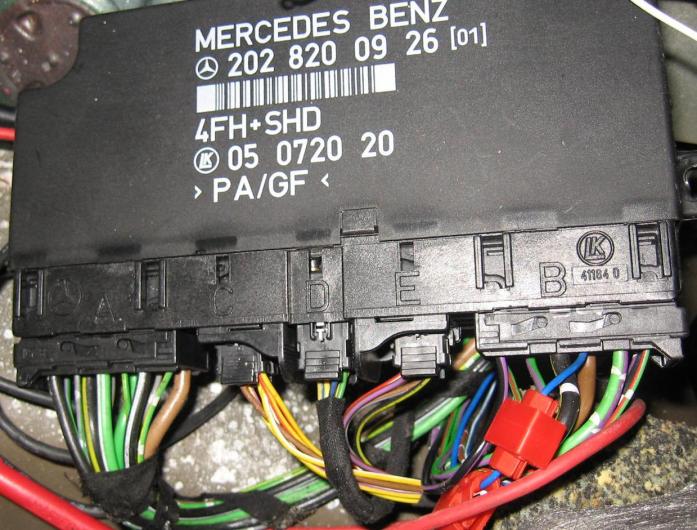

Help!
The random opening and closing of the sunroof is making me crazy!
Is there a way to disable the sunroof like removing fuse or something?

Under the rear seat on the USA driver's side (left side) is the convenience control module. There are five connectors, A through E. Disconnect connector "C" (the small one with mostly yellow wires) and the weird sunroof openings/closings should stop.
- FD

Thanks FB, it only took 2 mins following your instructions. Once disconnected it stopped, good thing it didn't rain on me.
Is there somewhere online where I can find this convenience module?

I would try eBay - I just checked and there are a bunch of them for sale for short money. Just search for the part number on your module (202 820 XX XX, but most probably 202 820 09 26).
