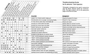

This is the other things to check out .

Quote: This is the other things to check out .
But you don't have KE injection , sounds like you have a miss fire or bad air mass meter to me

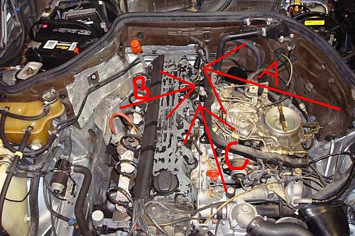

Just looking, and this is the one i was going off is a 1990 300e same injection type.
