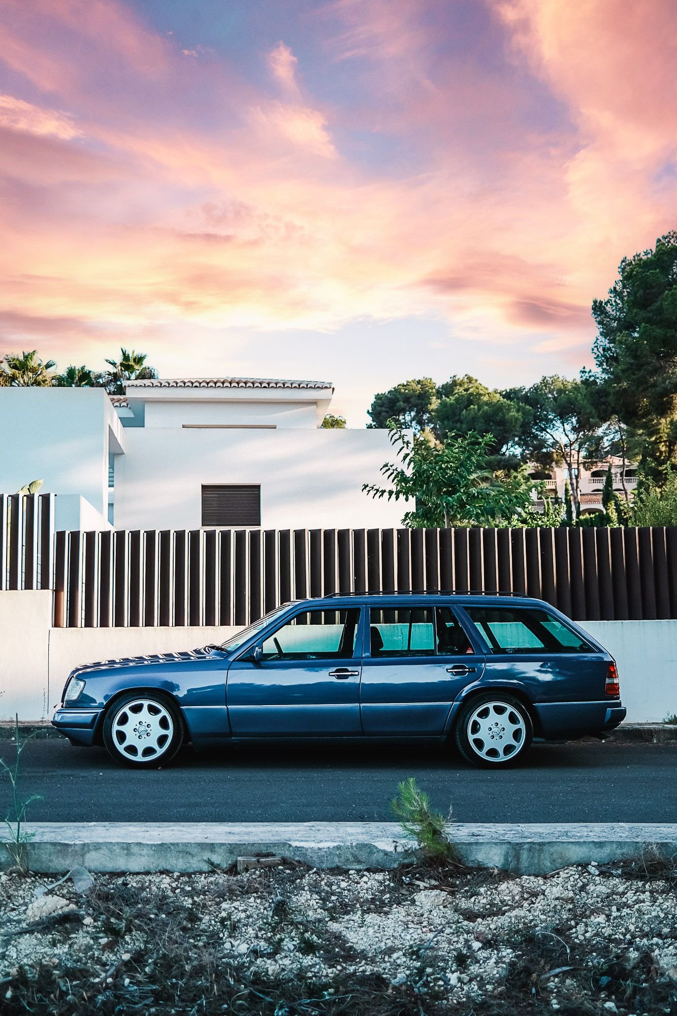

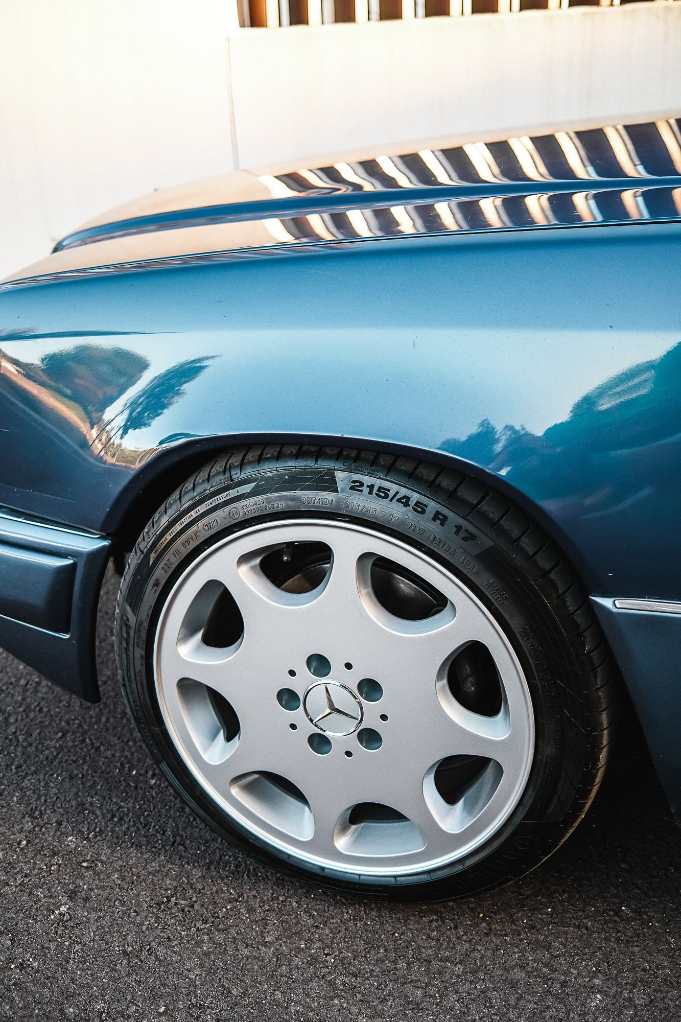

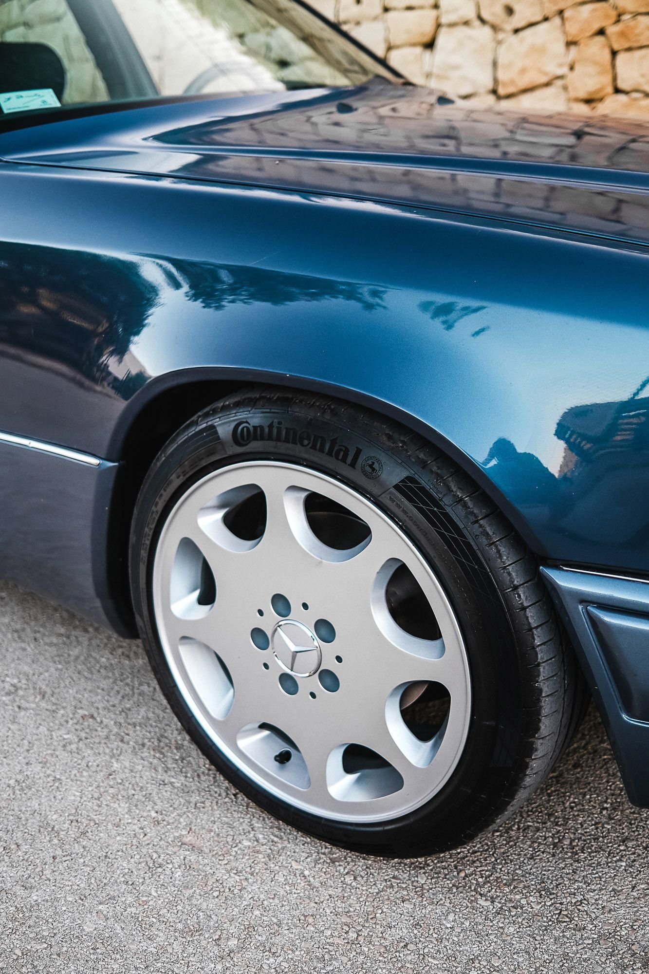

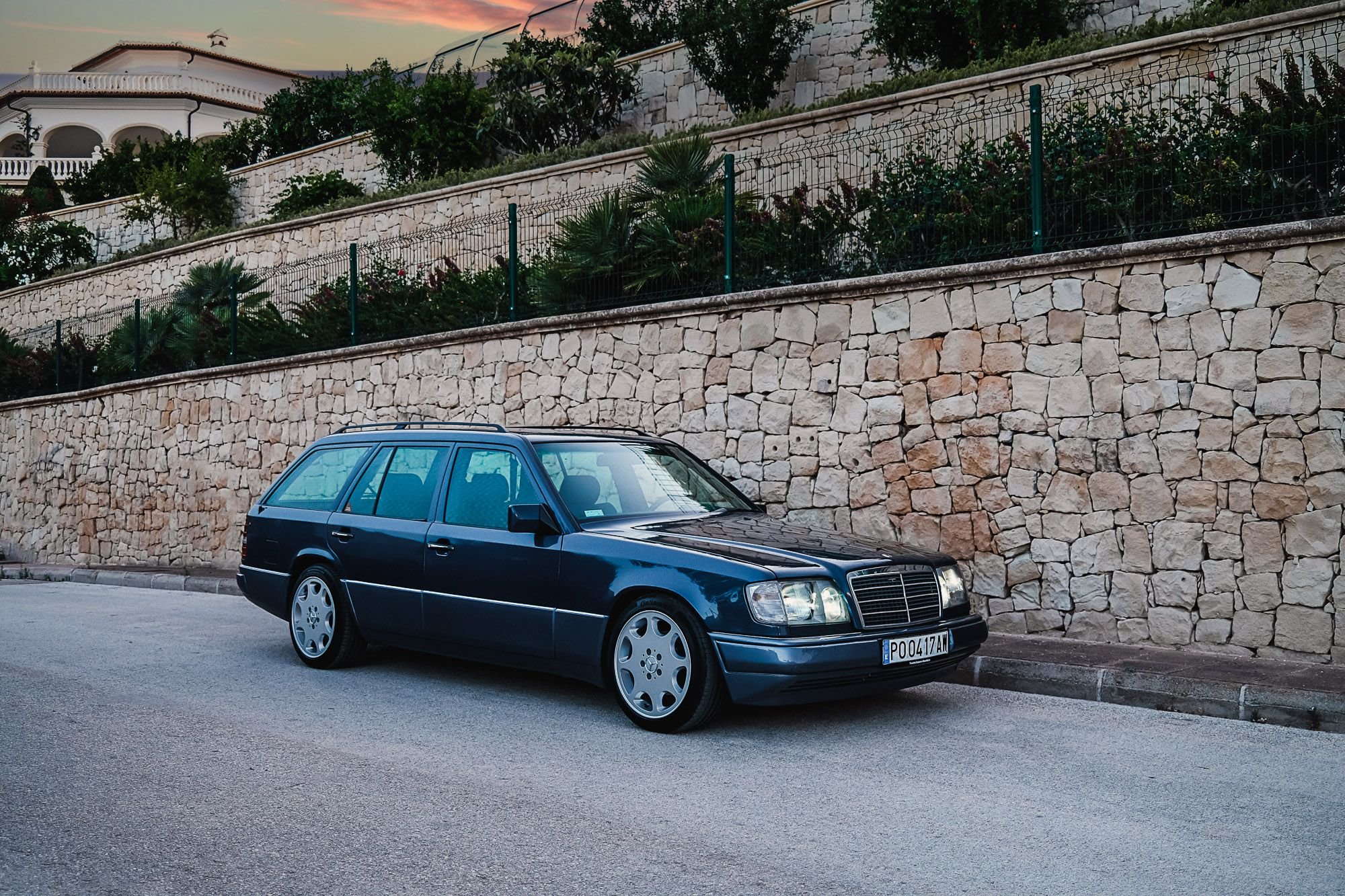

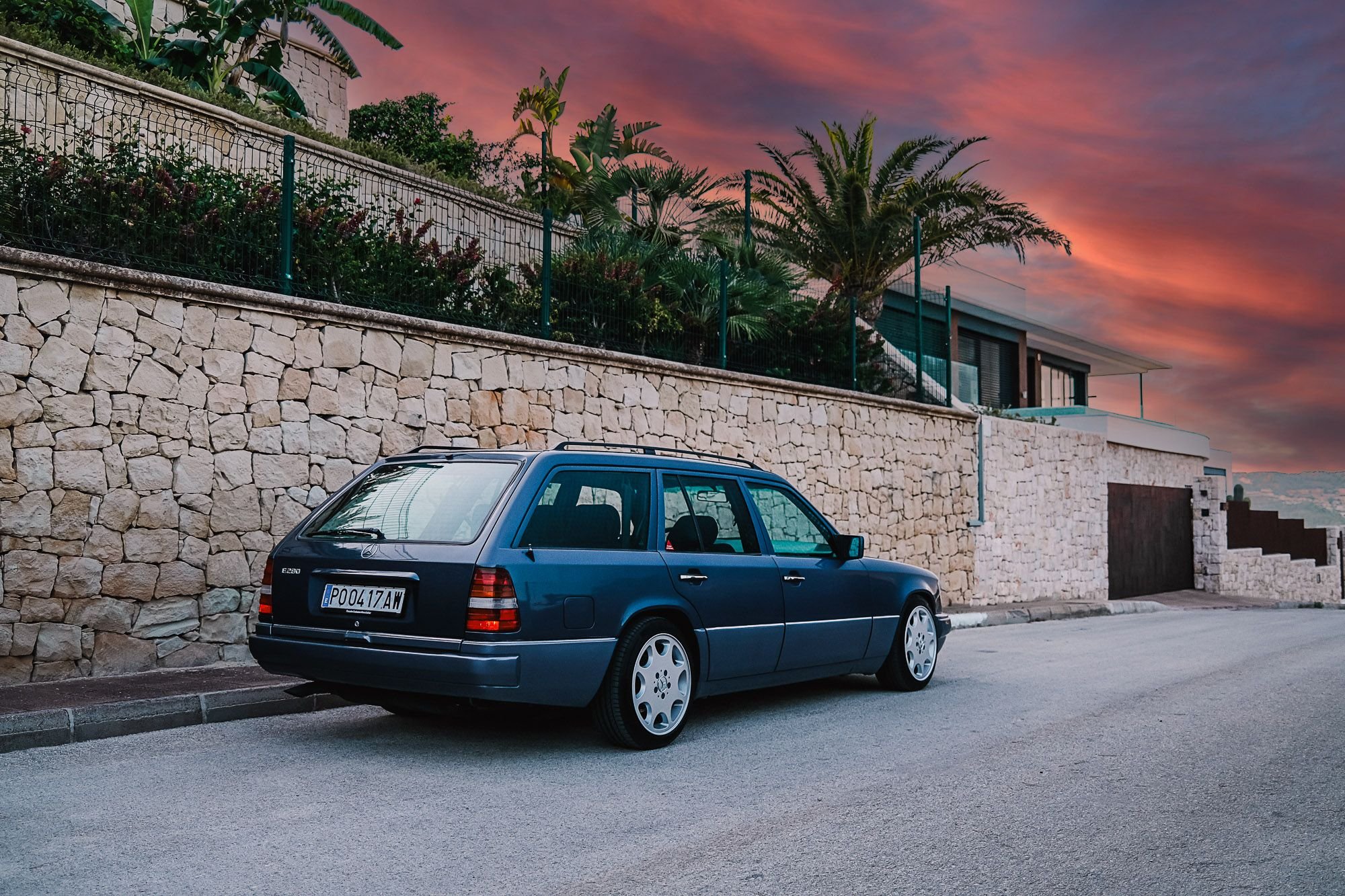

Old Jun 26, 2025 | 10:46 AM
Autology's Avatar
Joined: Jun 2025
1994 E280T (s124)
SPRINGS:
H&R springs, part number 29627-1 which are advertised as a 30mm drop, and have a slightly stiffer rate in the rear springs from the H&R 26-1.
DAMPERS:
Sachs OE replacement (standard damping)
WHEELS:
8-Hole replicas. 17x8, ET 34
Tires are 215/45-17 Continentals.
They're a little too narrow for the rims, so they's just ever so slightly stretched. I love the way the wheels look, but in a perfect world I wish they were 17x7.5 or maybe even 17x7...
