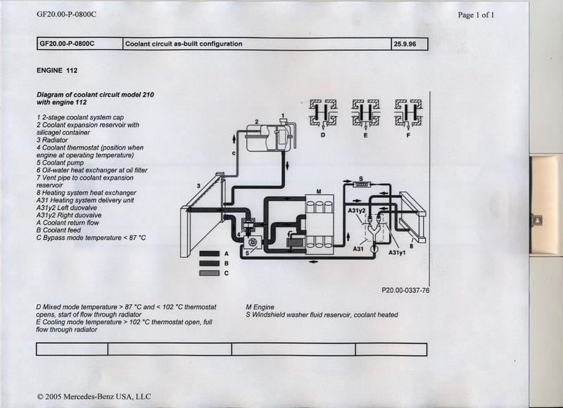

Coolant flow is from rear right side of engine ,,through heater matrix,, in to the mono valve and auxhiiary coolant pump ,,then out and back in to engine block so looking from the front of the car with hood up anti clockwise rotation .

This is how it works .Only change is some heater pumps are in the mono valve itself
