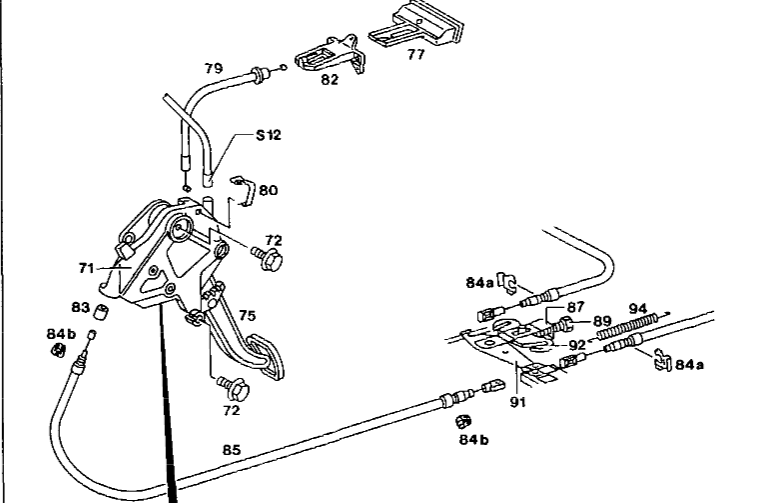

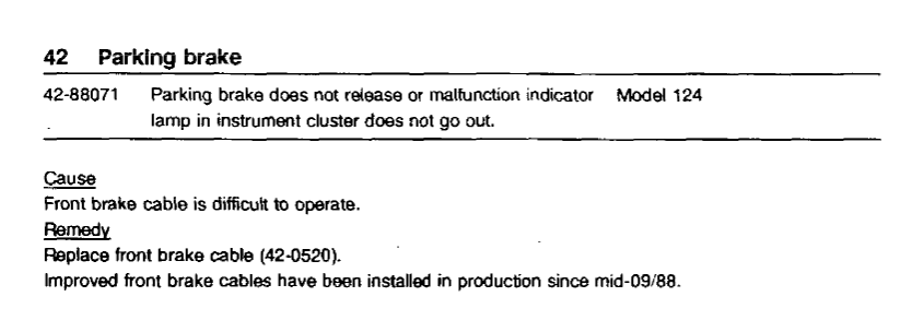

Aug 27, 2021 | 12:55 PM
I find spring return on the brake cable might be missing see picture Also other information tell you to replace front brake cable ..

Aug 29, 2021 | 11:45 AM
It does sound like it's a mechanical issue. To add to Trevor's comment, if you seem to still have trouble, it is NOT uncommon for e-brake cables to corrode internal. The rust build up can make it difficult for the springs to retract. If the spring doesn't fix or help, just try working the cable by hand when it's disconnected to ensure there is no internal binding.

Aug 29, 2021 | 11:48 AM
Quote: I find spring return on the brake cable might be missing see picture Also other information tell you to replace front brake cable ..
Great response and attachments. Helps us all, thanks.
