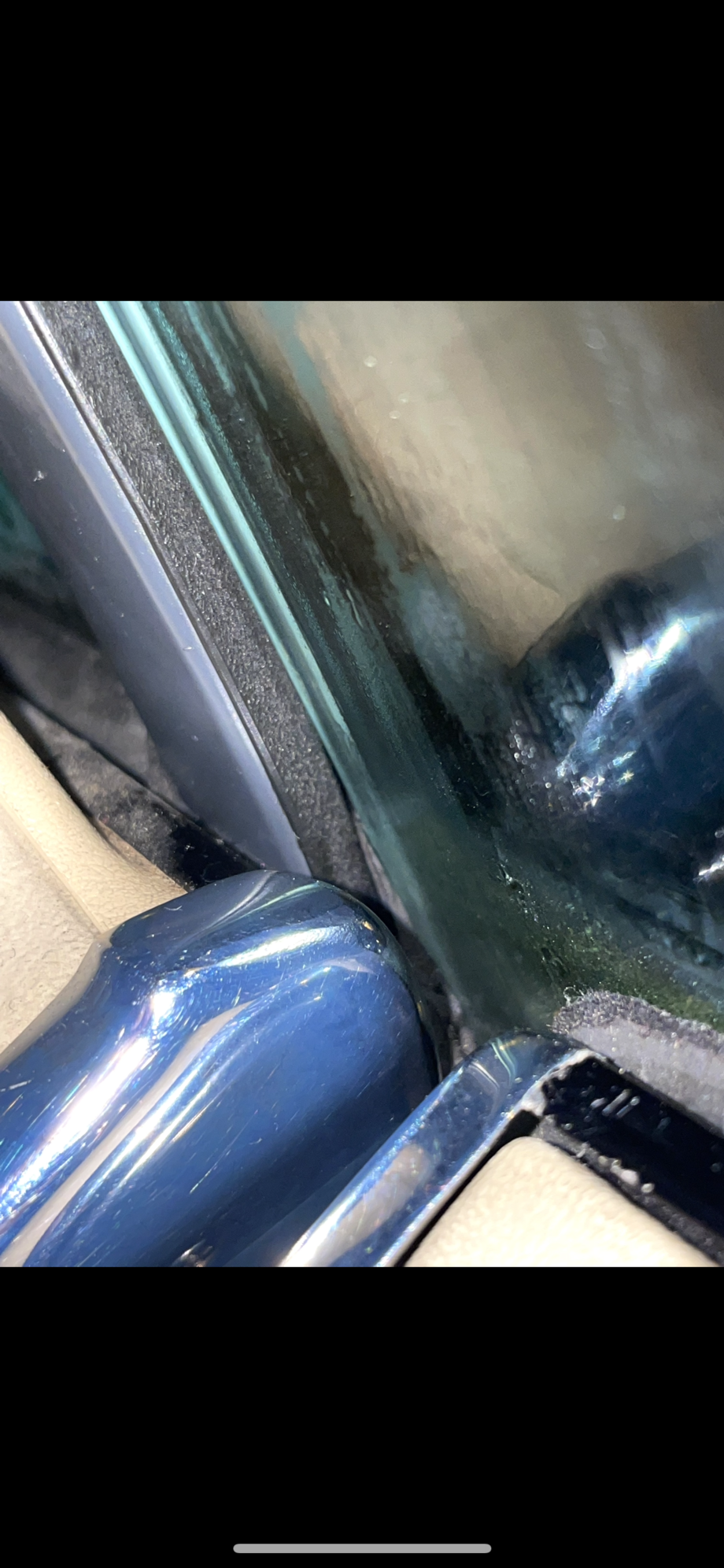

My coupe is leaking air from both the driver and the passenger side windows, the wind noise is horrible when driving at speeds greater than 60km/h. The seals are new, just replaced them and that didn’t fix it. Any alignments I should do? I tried adjusting the door inwards but that didn’t help. The ”hole” is in the rear, bottom of the front window, where the window meets the rear window seal.

Try placing tape over the suspected area on the outside and climb in through the passenger side. This will confirm you aren't wasting your time. Went through rolls of masking tape back in the day on warranty wind noises.
