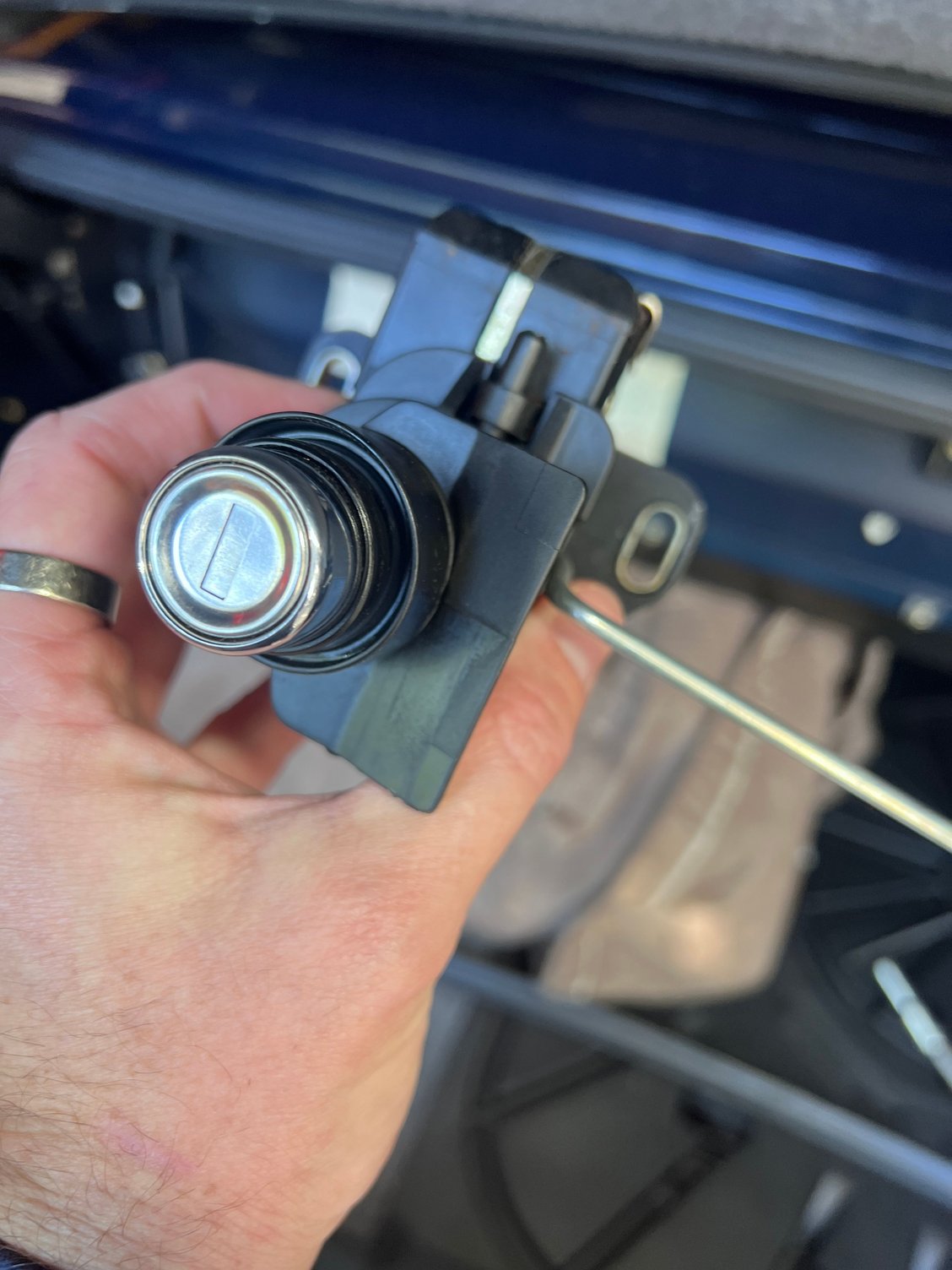

OK, so I've gotten the lock latch out, with the trunk lock cylinder in it. You'll remember I'm missing the key for this trunk cylinder.
Is there any way to remove this cylinder from the latch without the key ? (which is missing).... and just buy a new MB spare part cylinder that comes w/ a new key? Or do I need to buy a lock cylinder AND the latch thing it fits into? I do see that the latch wasn't replaced as it still has 1994 date code.

I'm trying to get this trunk lock cylinder out of the trunk latch (but don't have the key)
1994 date code on trunk latch. Still works perfectly.

BTW for future searchers. I figured it out. The key cylinder (and the black plastic around it) simply slides out of the bigger latch assembly with a little help from a screwdriver.
Basically just like this document which is from a W140, but by looking at this, I realized it's the exact same methodology to remove the W124 coupe / convert trunk cylinder assay from the latch.
