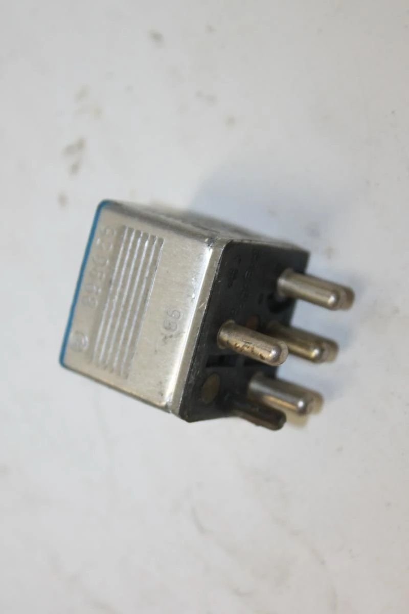

· After digging in the net reached to K17 relay which was working fine.
· got a very good chance to compare between my car and my friend car both E320 1994, non-ASD edition.
· Cleared some of the insulation to check the wires condition and they were perfect.
When comparing both cars relay k17, found the following:
1. the hand drawing attached as follows: the center fully colored circles in red are the one with the signal.
2. The one marked with (?) in my car giving high signal but the proper car it’s not completely.
3. In my car the center pole next to (?) terminal gives irritated semi low signal, in the proper car its giving high signal.

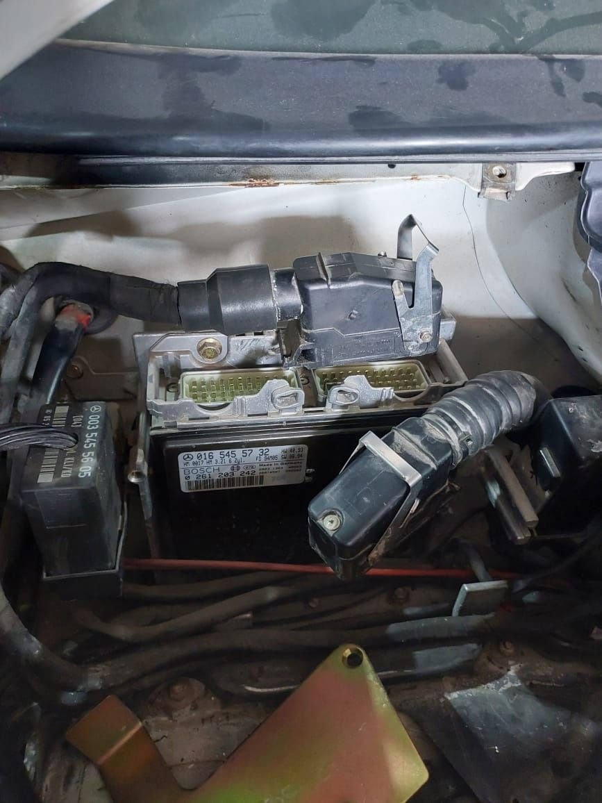

4. The harness goes all the way to the battery side of the car which is the right side so logically when traced it reached to the ECU. So, I thought maybe the ecu is faulty and giving leaked current to (?) pin in one way or the other.
5. So disconnected the ECU and checked the connectivity and yes, it giving the ecu reading both pins…this is only to ecu.
6. But when disconnected ECU terminal still K17 relay pins (?) giving the power signal from the multimeter.
7. How the K17 is connected to the air injector pump and no relay or ECU is connected.
8. I haven’t seen any connection or harness going to the fuse box. All going to the ECU area and yet I don’t know why there is signal in the K17 connection and yet shorting it out.
9. I believe there might be some other device connected to this relay and maybe in one way or the other it shortening out and leaking the current to the (?) pole.
10. I removed all the fuses one by one and relay in the same area but there no changes.
11. When connected the air injector directly 12v its working fine.
If any one has any clue plz advice cause its freaky.
