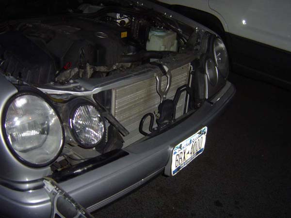

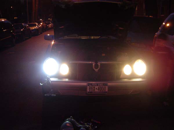

As i mentioned somewhere earlier that i got both of my OEM xenons for about $430. They came in today and i couldnt wait to intsall them. I installed them on a NYC street during a night time. dont care. anyways here are the pics b4 it was completed.
As for concerns I had no power prolems as of yet thank God! but when the car starts up there is now body shivering as if the engine is working harder. I hope that it doesnt continue.
On OEM xenon lights there is also another plug below the main power line and what it's for i have no idea, however, i had nothing to plug into it, and lights work fine.
One concern that i have is that how do i know my lights are adjusted the right way? They dont point towards the sky or anything, but what about the width, etc.

The other connector is for the auto leveling mechanism and from what I understand you have no choice but to leave that disconnected. There are sensors on the axles that detect if the car is loaded down and if so will lower the aiming of the headlights to prevent them from blinding oncoming traffic. Cars that are not xenon equipped from the factory from what I understand do not have the sensors, wiring, or control module that allows for this.
