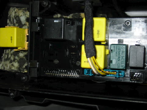

Hi,
I manage to open the fuse box & I see there is a hidden half of the fuse box, the RELAYS. But which is for AC? I suspect the one on top (yellow)
Attached Thumbnails A/C kept running non-stop-2001 E240-fusebox.jpg   A/C kept running non-stop-2001 E240-fusebox-relays.jpg

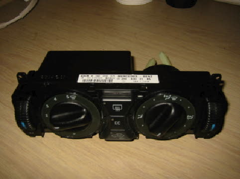

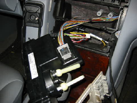

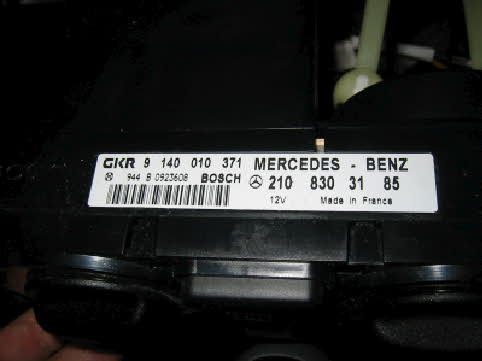

Hi again,
I finally manage to pull the AC Control Unit off. Attached are the pics I have taken. Surprisingly with the AC Control Unit disconnected, the Blower still kept blasting away. Is it back to the Regulator or even the Thermo Sensor Switch Faulty?
Can some one pls lead me in the right direction very much appreciated.
Attached Thumbnails A/C kept running non-stop-2001 E240-ac-control-unit.jpg   A/C kept running non-stop-2001 E240-dismantledpart.jpg   A/C kept running non-stop-2001 E240-partnumber.jpg

From the site, its diagnostics for Climate Control or Automatic Control Unit. But mine is a dial or manual type of control unit, like the pic I posted.

I will put the switch or control unit back in the front dash. However I notice there 2 white plastic (pencil like) which need to be inserted into the 2 plastic behind the dash. What procedure do I look for, in putting the swicth back?
