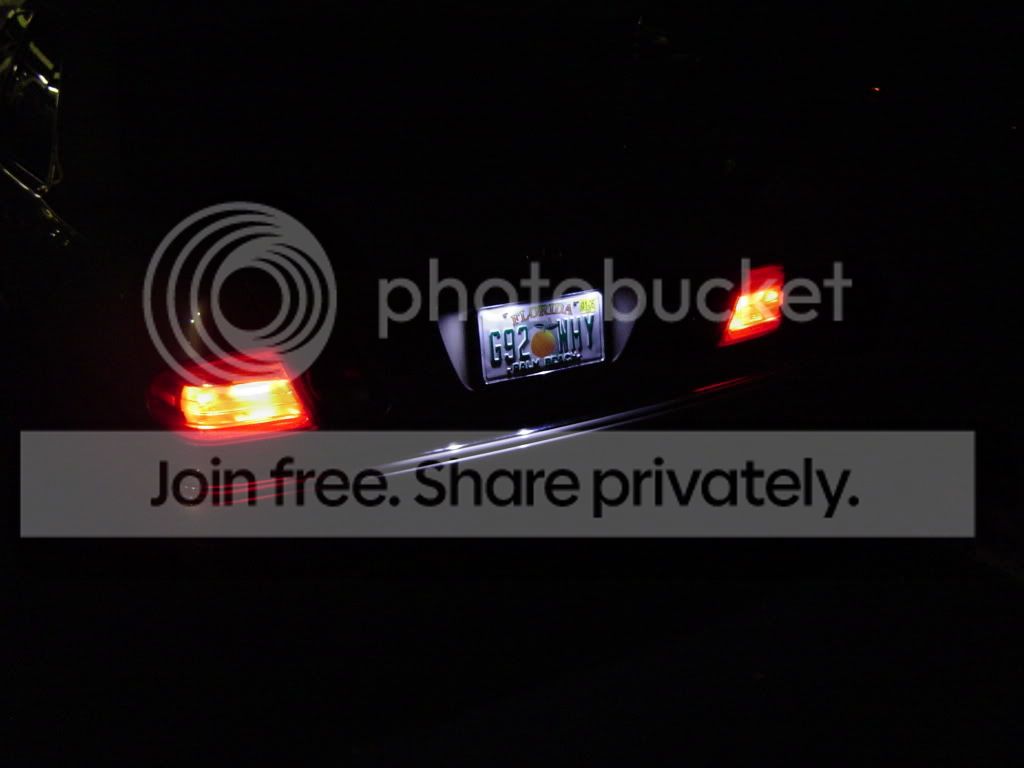

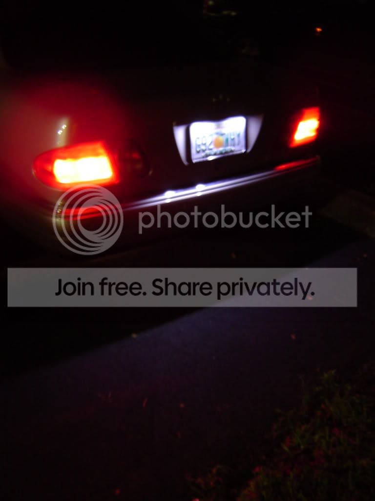

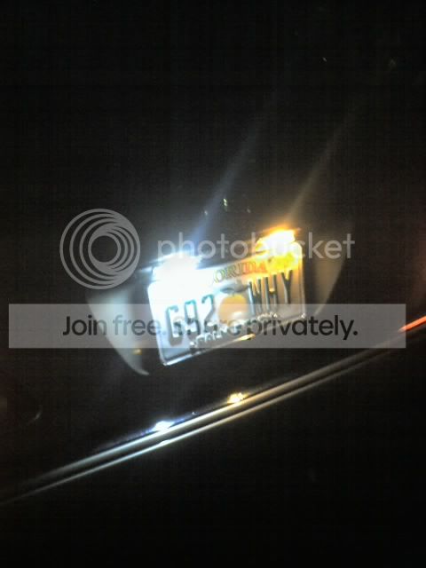

BMW X3. R33 skyline
i'm done
new mod
half way
angle one
angle two
looks awsome in person just that clarity a crappy camera can not bring out.....i'll have to go get the other camera to REALLY show how well it came out

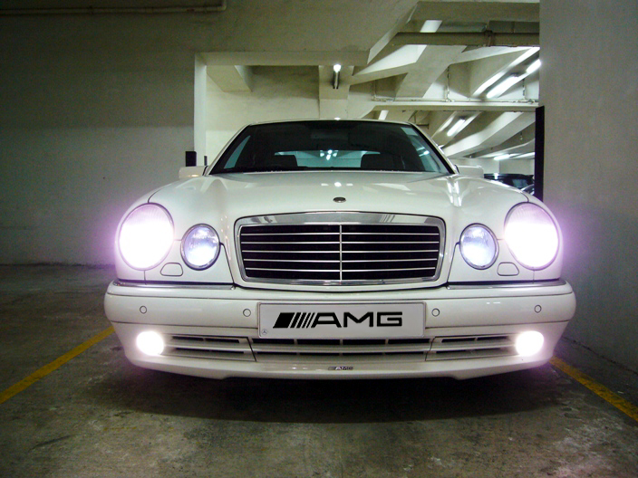

The 100ohm/10W resistors are just right - together with a functioning LED festoon the consumption is just enough to fool the computer, whilst in the absence of a fully functional festoon, the light out warnings will work.
Technically (Ok, I'm no electronics whiz but purely from experience messing with them), resistors hooked up in parallel do not affect the amount of voltage going into the bulbs (possibly the amppage might be affected? no_clue, anyone?).
As no_clue had said, the durability of the festoons in this case depends very much on the quality and build of the festoons themselves. In an earlier discussion, we concluded that the voltage put out by the car's electrical system fluctuates (you can see this on your on board diagnostics, in fact, the voltage is usually more than 13V), sometimes (though momentarily) much higher than 13V. Therefore, if the festoons are built to withstand up to 12V only, they will fail prematurely...if they are built with a bit more tolerance, then they are unlikely to fail under the fluctuating power supply. Unfortunately these festoons are typically spec'd 12V, so there's no way of telling whether they will withstand the max power put put out by the car...other than trying a number of brands.
Meanwhile, thanks to V8 AMG for giving me the headsup on the LED citylight mod and bearing with me on my exploring the best resistor ...here's my mod for under 6 bucks - (despite the pic) much brighter than the stock H6W bulbs and of course, pure white .....(N.B. the bluish hue is mostly from the pure white light picking up the grey sides of the light housing )
