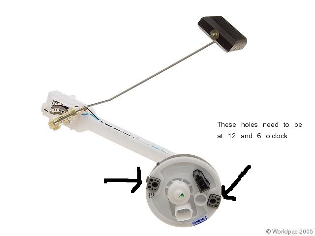

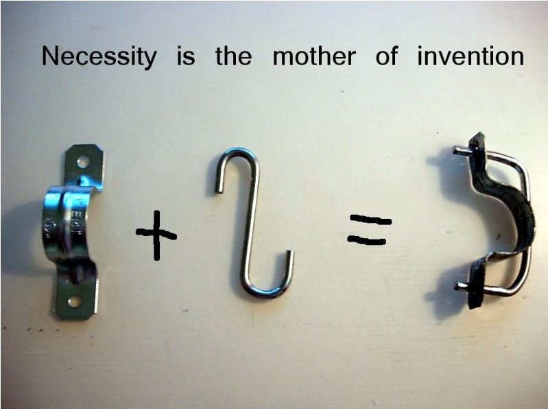

I have been having some gauge issues, and I wanted to check the sending unit. I needed the tool to unscrew the unit. I made one from stuff I found in my junk drawer (everybody has one, right?) It worked like a charm and didn't damage the part. Check it out... UPDATE: Just filled up and the gauge reads FULL! Seems that the FSU needed to be rotated slightly so that the holes are at 12 and 6 o'clock. RESULT!
