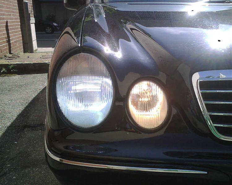

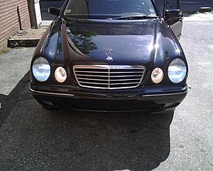

here's some pics I took right now at work. It's really sunny out right now and they still look good....i'll take more later. Excuse the car, its usually clean..

This is the thread I used for the install, at the bottom of the page there are pics of an 03 E320 and how well the lights work. I took a few of mine last night from my phone so the quality isnt great.
My passenger side headlight is a little low only because I am missing the piece that locks the bulb in place so it slips down after a while bcasue its not locked in. Once I get the piece the lights will be at a perfect angle.

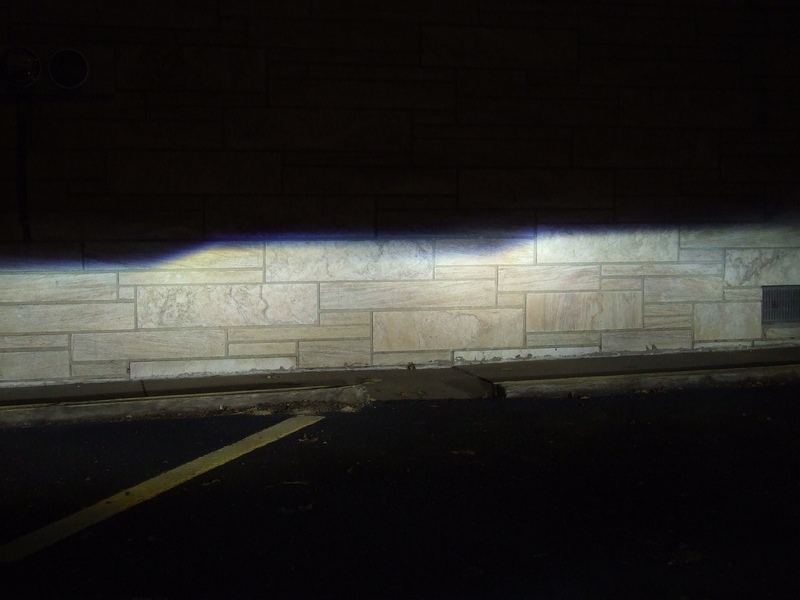

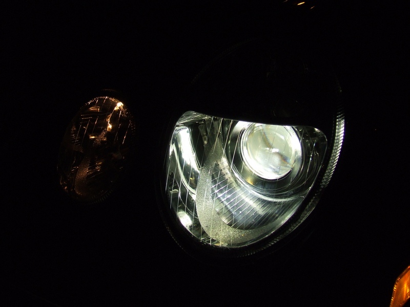

Here's my set-up...
Parked from about 18ft away, I am very satisfied with my set-up. Needs some minor, I mean, minor tweaking. However, that requires taking my bumper apart, and re-baking the lights...not really in the mood for that. Unless the lenses fog up (siliconed it, so not likely) or something else, I am leaving it as is.
Attached Thumbnails New HID setup-dscf7651.jpg   New HID setup-dscf7652.jpg   New HID setup-dscf7655.jpg   New HID setup-dscf7656.jpg

that setup looks very nice, does it look different than mine because yours is bi-xenon?

no, it's because he used an HID projecter calibrated and approved for road use.
If it's still not apparent, it has to do with design and focus. You have cobbled
together a lighting system which has never been calibrated. Like any optical
device, the focal point needs to match the lens.
If you take a magnifying glass and try to start a fire, you need to move the
lens so that the focal point concentrates the light source.
If you place binocular to your eye, you need to adjust to the occular so that
the focal point is adjusted to the target.
If you take a projector headlight which is designed for the focal point of an
H7 halogen bulb....and you swap out and replace with an HID bulb...which
has a different focal point, as well as different characteristics, it will change
the throw of the light as it passes through the projector lens.
Given the high intensity nature of an HID bulb, ie 3x brighter than halogen,
the glare emitted is less likely to be casually waved off by other drivers.
Your solution, if you desire to have precision lighting is to purchase OEM
light components. After all, the R&D has already been done on these units.

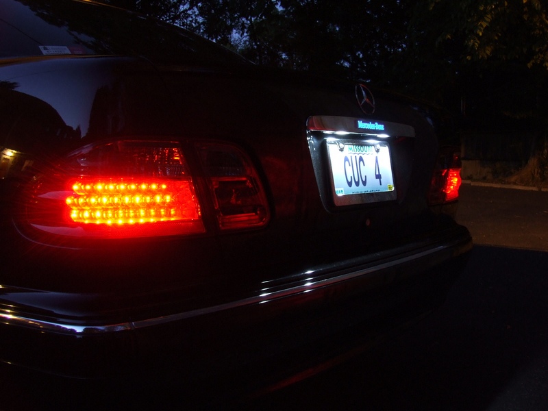

Whats the deal with that trunk set-up...details? I looks pretty "bright"
Well, if you noticed the new Lexus GS and LS, they have the LED license plate lights. In addition, it 'cleans up' the look by giving the trunk an updated look. I went to superbrightleds.com, bought some LED festoons and load resistors, and there you have it. The EL trunk lid is a matter of personal taste; some love it, some hate it. There's a thread called "$10 modification". Look it up and you'll see the details.
