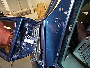

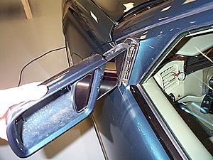

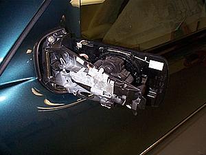

Be careful the cast attachment points for the spring are fragile, try to avoid folding the mirror too many times.
In the third pic you can see "how I know" how fragile the cast frame spring attachment point is.
